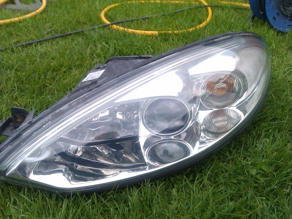

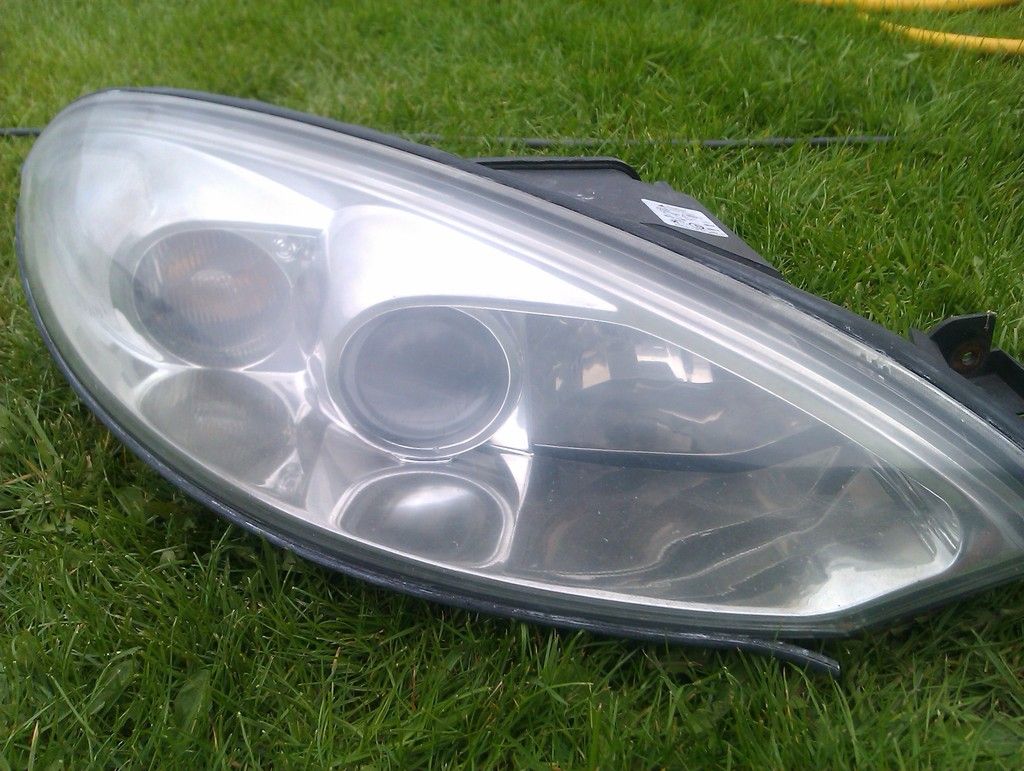

Basically all you need to get the job done on small to medium sized headlights. Don't expect the P500 disks in particular to do both cougar headlights, the UV coating really is hard stuff and takes it out of the sanding disks. Personally, i would use a slightly courser grade of paper for the first sanding, especially if the original UV shell is damaged, then follow the P500> routine. The P800 and on seem to be more than enough to finish the job. If i had any critiscism or comment, it would be to add a few more of the P500 disks.
I spent nearly 4 hrs on this one C2 headlight but it was seriously scraped and dulled, so bad infact, it made the other one look shiney.

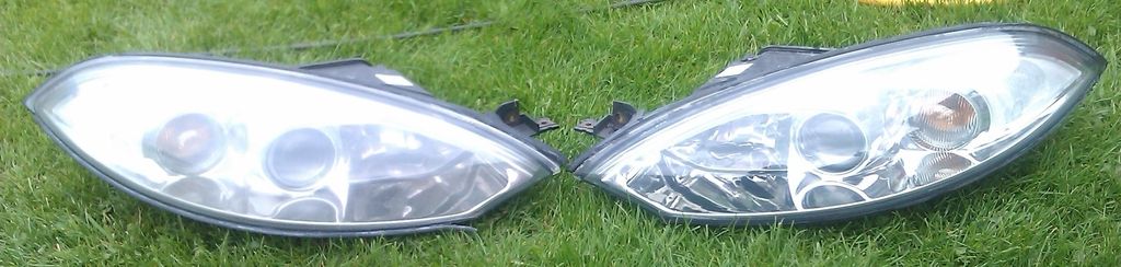

Result: Very good indeed.
...and for comparison: This one should be a doddle.
