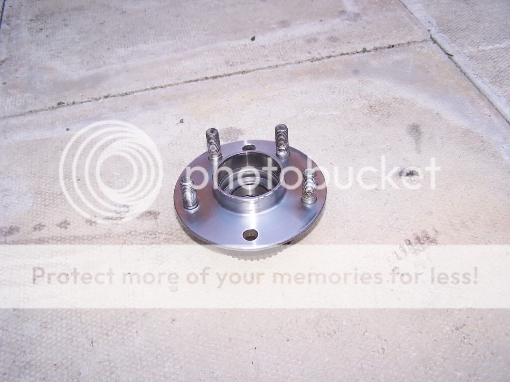

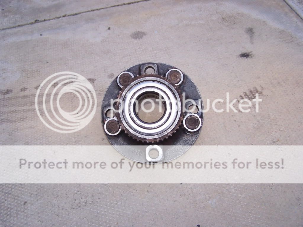

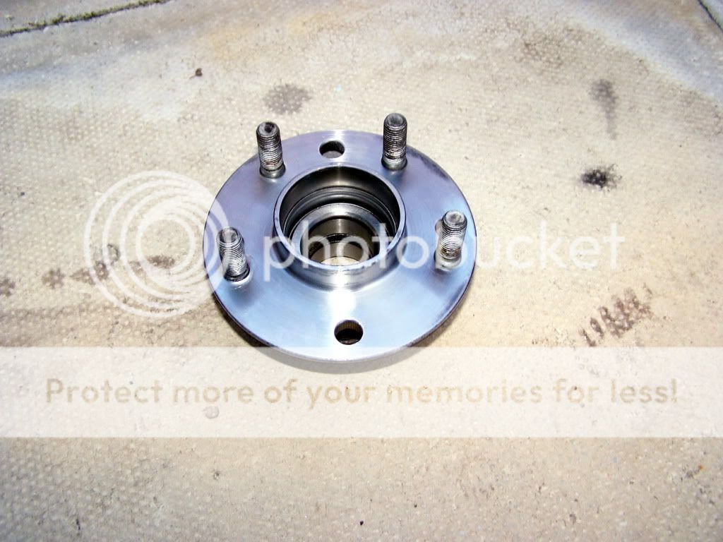

Okay that's what I was reading... Mk3 mondeo for the fronts swap right in and the windstar from like a 2001 will need a lathe to take some off, abs rings swapped as well. Anyone know if the mondeo 5 lug spindle will press into the cougar hub itself?
