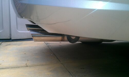

back garden fabricated exhaust...with only the middle silencer :)

cheers! :) contemplating the decat now....i always planned to re-pipe to the cat....just a question of which side!!
andy....have a look on my profile album, i fabricated a Y piece and fitted it just after the exhaust centres itself after the fuel tank, after that each tail pipe is exactly the same, any more info required...just gimme a shout

ive just avoided that (by about 15mm) with the nearside pipe, if i do put boxes in they will be just after the Y piece slightly off centre so they fit, im gonna hack the tail pipes off though and put a 3inch slash cut pipe on each side and take them in a bit and up also....next time the weathers good and time permits anyway!!!

found a spare minute after work to alter my exhaust again as i wasnt keen on the rolled tips, and they were a tad long so took an inch off and slash cut, im pretty happy with them now
(and it appears i still cant post images properly! lol)
