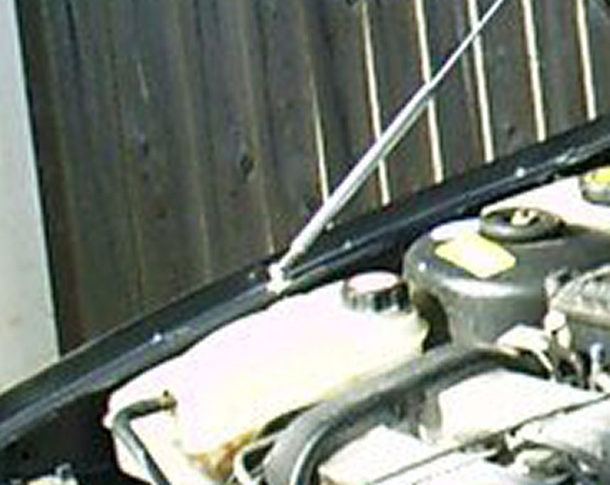

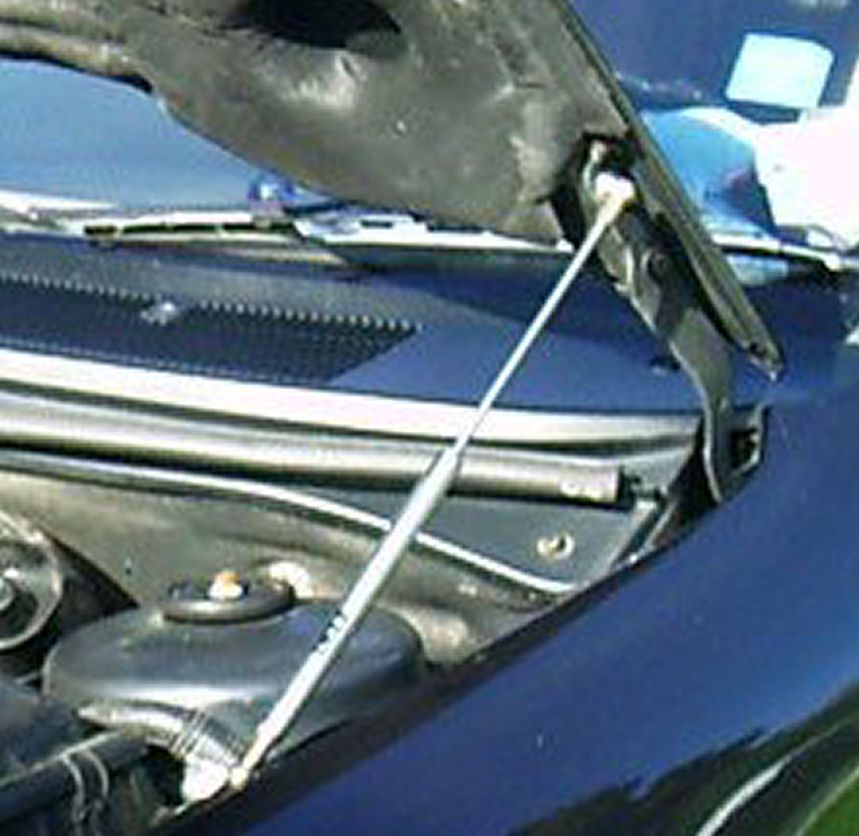

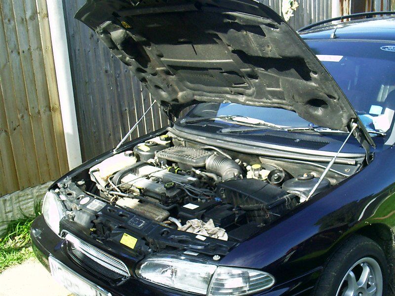

All i can find, but i remember the hinge bolts as seen in the photo, also i remember the wing bolt/ball joints were indeed self tappers. Sorry mate but i don't seem to have anything else showing them.
Yep, that's the ones, the bottom bolts should not be a problem, but the ones the fix in to the hinge i think i may have to buy a bracket as the cougar's hinge is the other way round and flat.. (y)
