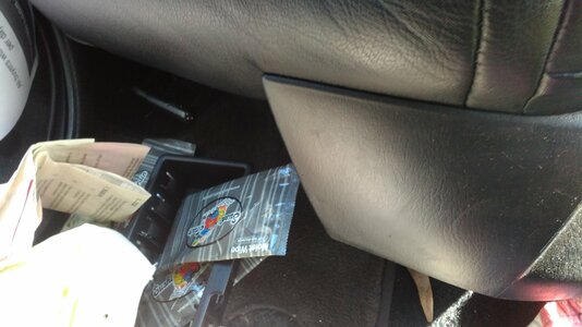

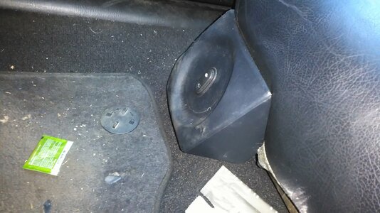

So I was fluffing around trying to move the seat back and was feeling around and couldn't find the bars that control the movement but I managed to find the power height adjustment button and No heated seat buttons on either side?
I thought that was quite strange as I've never seen another Cougar advertised in Oz without the heated seats or power adjustments, I suspected it was standard kit over here.
So I am still considering the purchase as it is only a couple of miles away from my house. But my main question here is, can I possibly take the headrest, leather and padding from the C2 seat and reskin my C1 seats on my current one? to retain the power functions. If so, you may see a C2 on here wrecking for parts :D

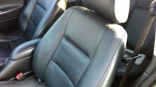

Drivers side:
Passenger side:

I have no idea whether the internal frames are the same between C1 and C2 - there might be differences to account for the wider base and bolster - but the thing that immediately leaps out at me is the potential for the side airbag cylinders being different.
The bases are likely to be identical and swappable, though you then have the potential risk of losing powered tilt and lumbar support. Again, I've had C1s apart before but never a C2. Personally, I'd probably pull apart one of the C2 seats, and compare it to pics (there's some here somewhere) of a C1 with its clothes off.
As for the fact that they are leather but not powered or heated... You mention that a previous owner had them re-skinned at some point. Could he have meant that they were originally cloth and he re-skinned them in leather? See because I've only seen manual, unheated seats in cloth, (though to be fair my experience of C2s is very limited, let alone Australian Cougars).

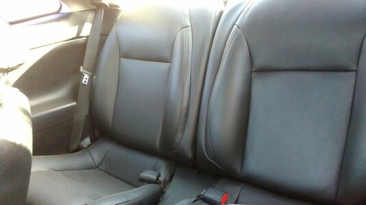

The Ford leather seats are part-perforated leather; the surfaces that most contact your back and seat.
It might be that the rear seats follow the style of the front, necessitated by the heated seat elements.
Yeah the rears follow the same pattern as the front
the modification is easy enough to just swap over the c1 base plate with motors and have the C2 foam and leatherette (y)
Cheers for that mate, makes my decision a lot easier. :) Will they still look/feel like C2 seats if I put them on the C1 base?

Just another quick query, after I sat in the C2 with genuine leather seats in them (With the power options) the side bolstering on both the back and the bottom part were nearly rock hard. I thought this seemed strange as my C1 seats are very soft. So I checked the C2 with the re-trimmed seats and they were really soft like my C1s.
Does anyone know whether the genuine leather C2 seats are supposed to have the hard side back and bottom bolsters?
Cheers.
Yeah, they would be if they came off the line at Flat Rock.
I wonder whether WildRacer's ones are either C1s modified by someone - since C1s are a bit rubbish - or just worn out?
I'm not sure if my C1s are modified but I have a second C1 (for parts) and those seats feel even flatter (but still soft) than the ones in my eibach.
I just thought the C2 with the original seats that the guy at the wrecking yard has might have been sitting out in the sun too long so they went hard? I haven't ever sat in another C2 apart from the one with re-trimmed seats (Which were originally cloth) to compare it to.
