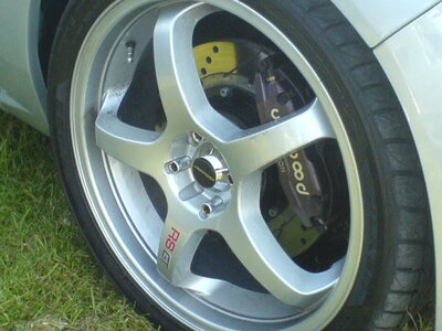

I have a pic on my pc of said car...you need minimum 17inch wheels too
Ginja, are you able to find out more about the brake and caliper setup used in your photo?
Does that car have Wilwood calipers at the rear, too?
