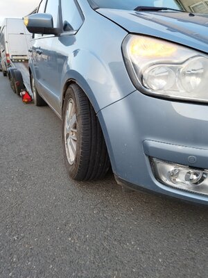

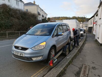

Driving back from the shop today I saw a work colleague stranded at the side of the road at a busy junction. Initially I was concerned he had been in an accident, but I discovered that a car had pulled out on him and as he slammed on the brakes, the offside lower wishbone had basically exploded, on a quick inspection seemingly down to having been weakened through corrosion. A lucky escape - at least he wasn't doing 70 on the dual carriageway at the time!
Fortunately we managed to organise a tow. Tilting trailer, but we had to take it in turns to man the hand-operated winch! Good job it's nearly tea time!

could u see where it snapped matt?
it would have had to have been SEVERLY corroded to break...something the mot man should have picked up on even a year ago.
but then its a front heavy ford galaxy? and with all the pot hole and speed bumps about this component is one of the most stressed and disregarded parts of the suspension.
Reactions: HogMonster
Not really mate. It was in more than two pieces though, and obviously the driveshaft was hanging out. He did let slip that he had the passenger side replaced for the last mot - I told him he should have bought my Mondeo, I had both done at the last service.....🤣

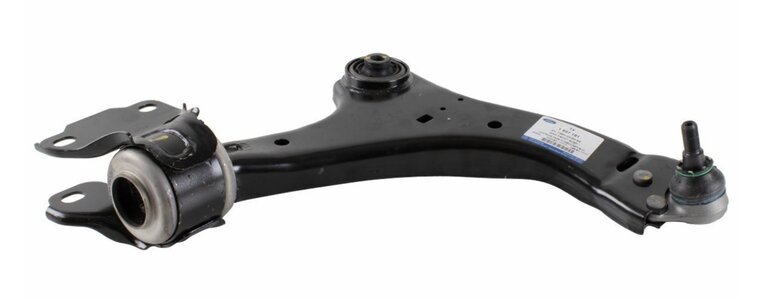

They are a completely different design to 'our' wishbones with one large horizontal bush secured within a collar(to the left of the photo)which is bolted to the subframe. If corrosion has got into the collar and weakened it I can imagine the sudden pivotal force of the emergency braking around the smaller vertical bush has forced the larger bush out of it's collar.
Genuine part from Ford is over £300.00
