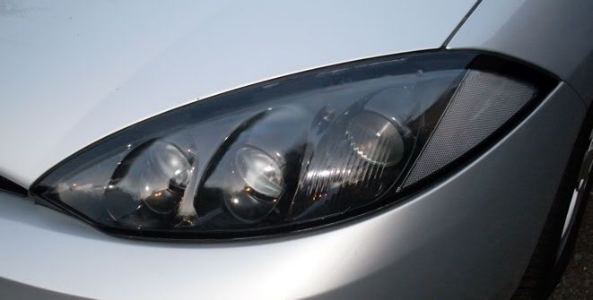

I've always thought my Frosty is pretty tidy, but Ford Fair the other week showed me the truth; my headlights were a yellow plastic mess. I've been that close to buying new ones but the idea of replacing something I don't have to doesn't sit well.
Today I decided to go for broke.
I used 480-grit wet-and-dry, wet and soused with washing-up liquid. Then I used Halfords own "Intensive glass cutter", (yes - I know they're plastic!) going slowly and in tiny circles. I followed up with Mer polish, then Megiuars glass cleaner to remove any residue. I then coated it all with Meguiars Instant Spray Wax.
I'm not finished yet - I think they can be better - and will go at them with some 2000-grit (assuming I can find any) and smoker's toothpolish. But here's where I am now;
I suppose many people here have done this before, but if you haven't, taking glasspaper to your lights isn't anywhere near as scary as you might think if you just take it slowly, use some care, and finish it off right.

Thank you muchly. I've not seen yours in person, but mine just tipped over needing doing. Night and day, as they say.

Thank you - I figured they would. I only did this, (and tested a small area first) because I thought I'd see what happened as I've never needed to do it before. Will definitely take it to the next level though!
Offside done to that standard as well, but I didn't take a pic as the light was failing.
