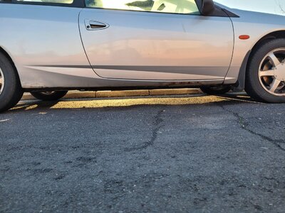

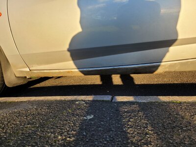

I have owned my 1999 v6 for about 8 years. It's due an MOT at the end of this month and my garage-owning friend has told me it's going to fail massively on the sills as they're rotting badly.
I've been told that the whole lot would need to be cut out and new sections welded in on both sides - not something my mate can do and something that is likely to cost a significant amount of cash for a specialist to sort.
More than that, I've been told that it's started rusting around the points where the rear suspension is attached.
I'm slowly starting to accept that this is terminal but I'm going to be absolutely gutted if I have to scrap it. Yes there are a couple of minor issues but the car is pretty tidy - there's no rust on the main body itself and it's only just ticked over to 89k miles.
Has anyone experienced similar? If so, have you been able to sort it or was that the end of it? Thanks.

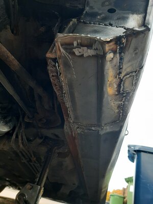

here's just a couple of pics of my auto for u...your car isnt the only one to suffer this..
b4
i hope some of this helps u reach a decision ,the worst looking hole can be repaired..

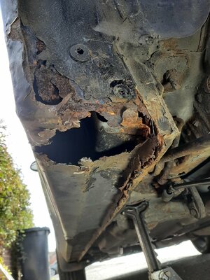

Hi all. I've attached a couple of photos showing the problem. It definitely needs the sills cutting out - it's already been patch welded (not brilliantly) and it's started going again where that was done. I was also told that it's spreading to points for the rear suspension. I've not had a good poke around under the car myself as yet but it was up on a ramp the other week and I've not told that it's rusting anywhere else.

In my Cougar sill experience, IE just my car.
The front 3 inches first
Then the rear 12 inches.
Then the middle.
I‘d patched at least 3 of the 4 ends and I could detect the middle was going to be next. It was Time for a full sillectomy. Job done.
When you take the sills off you may well find the base of the A post needs attention too. You might get away with treating it, but if it comes back and rots under your new sill it will spread and you won’t know it’s happening because you can’t see it.
They also go where there is a surplus bracket in the front footwell area, underneath the car. Around where your accelerator heel is when driving.
I cut the bracket off, cut out the rot then shaped and welded new metal in. When you lift the carpet and under layers you’ll find the harness resting in a shaped trough in the floor, so the patch ideally needs shaping to maintain the trough to keep the harness not under your feet.
She looks good, it’d be a shame to lose her.
Reactions: David` and jibs
I agree with mabo. The patch you had done is poor so I'm not surprised it hasn't lasted. Looks like they just stuck it on top without properly cutting out the rust. I was wary of anyone that offers 'mot welding' cause that isn't going to last. You ideally need to spend a bit extra and have the area wire wheeled back to metal and cut everything that isn't clean out until the rust has gone, then get the new piece of metal welded in flush with what's left
