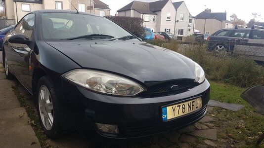

Well we replaced the t shape hose/sensor that was broken, dad took it out for a run and it promptly overheated🤦‍♀️ so he's taken off the waterpump and thermostat, waterpump seems fine so that can go back on - just waiting for a new gasket. He's going to try running it without the thermostat to see if it runs cool or still overheats.
Good news is the clocks inexplicably came back to life after we charged the battery😂 so we put that one down to a cougar-ism lol.

Well she's running fine without the thermostat so looks like I'll be getting one of those so that's no biggie😀

Car was owned by ukcougar member franspeed previously so you may well have seen it before.
