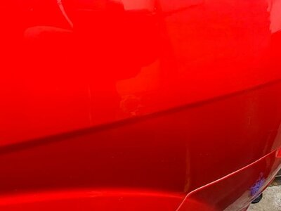

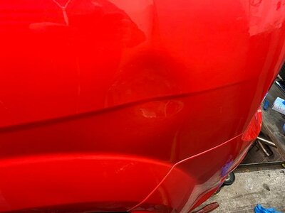

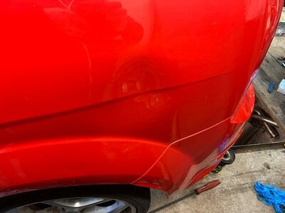

My Dent..GRRRR...
More GRRRR...

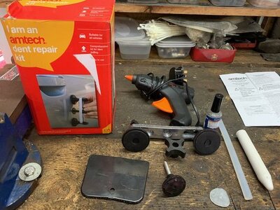

Here's the kit...
simple instructions really, just follow them and you should have no problems, I am usually a heavy handed thug, so was a bit (shall we say) apprehensive...
.. so I just "crack on" and dive in...

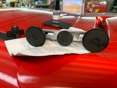

that little lot below, is the tool for the dent removal, the middle bit is the part that you put the glue on, once you have heated it up with the glue gun that comes with the kit, along with the glue stick, you place the "plunger" in the middle of the dent, holding it, not pushing it or pressing heavily, for approx 30 seconds to let the glue adhere to the paint surface, then place the bar with the 2 (don't know what to call them, black round things) over the top of the centre plunger, you then have to put a wing nut, supplied in the kit onto the centre plunger, it has a threaded bar so you just tighten the wing nut SLOWLY... and it pulls the metal out then... hey presto the dent came out....

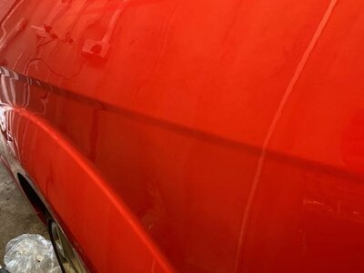

Look NO DENT...
Pretty impressed with my work...
