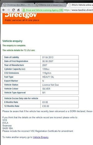

hmm, few things to pick out there
looks like the wishbones were done in 2008
no test in 2009?
after years of advisories on the subframe it finally failed this April, to the point that the ARB mount had rusted/sheared off
test was in LLanelli
six weeks later it's in Lincoln and failed again on the subframe, advisory on drop links, front discs and ARB bush
three months later still in Lincoln failed on rear brakes, advisory on play in steering - rack? and front drop link
would appear the front disc and rear drop links are sorted by this point
passed the very next day with the brakes seemingly sorted but still with steering play and drop link worn
at the very least Id be getting cast-iron proof that that rear subframe was done properly
Is it still in Lincoln? shoot Rik a PM and see if he'll take a look at it for you in exchange for beer tokens
its X601 now
Perhaps its just me but compared to my recent MOT's thats a sh.t load of work if half of its been done. If it was me i wouldnt go near as i would suspect further corrosion that you may not be able to see easily (e.g. inner sills).
its X601 now
Yeah what I was thinking, my Cougars two years older and solid as a rock underneath, think I will keep looking for now.
I wouldn't want a car owned by a mechanic unless I knew the mechanic and the car well beforehand. Shoemaker's children and all that. From those advisories it sounds like the car has been maintained by someone experienced in knowing how much longer something will last. That's great if it's your own annual budget, but not so good if you're buying a car with a great deal of deferred maintenance.
