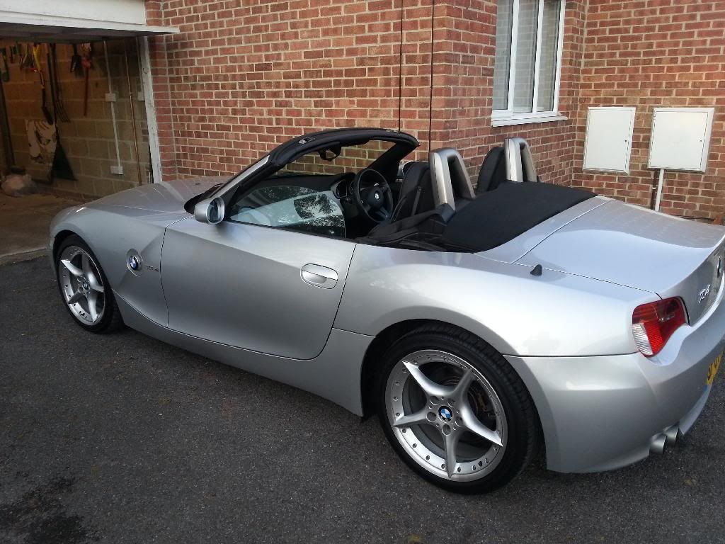

A few weeks ago I bought myself a new toy;
BMW Z4 3.0si Sport:
Hope you'll all agree that its a nice Cougar replacment.
Chris
I've never driven one so have no idea what it's like to live with, but anecdotally at least I hear that it's great fun. Apparently the handling is very entertaining.
Not as handsome as a Cougar though. ;)
I'm guessing by this time you've researched the heck out of it, but in case you haven't, make sure the roof motor is dry. That seems to be the only major fault with them, so can't say fairer than that.
Thanks Jamie, Yeh Mako I read the roof motor can be a problem if the drain holes arent cleaned at its service.
All its previous services have been by BMW so hopefully its been done. I've also got 15 months warranty on it, which give me some piece of mind.
My daily driver is a LR Freelander TD4, the Z4 will be my weekend car and a bit of fun in the summer evenings. The Z4 wouldn't be very pratical to live with, although its boot is bigger than some convertables I've seen.
