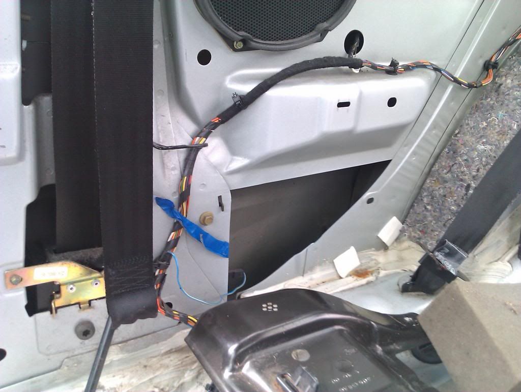

The triangular opening has a black panel covering it. I have obviously removed it. Iirc there are "HOWTO's" in the relevent section. I have bruised fingers and it is affecting my typing volume :)

Just thought i would show you how mine looked after i painted red lead from front to back and anywhere a paint brush would go!!
