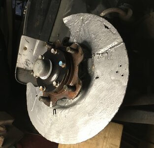

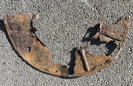

As a minor update. The GV now has. New rad to get rid of a persistent water leak, home made replacement front disc brake shields welded to the remains of the old ones so the worst of the rot cut out ( prob 75% of the shield ) with the remaining treated and the whole lot hammerited. Front calipers cleaned, freed off slide pins greased new pads and more hammerite on the calipers. ( replacing the whole shield would mean stripping more apart than I want to at present.
The shield, worst section removed.

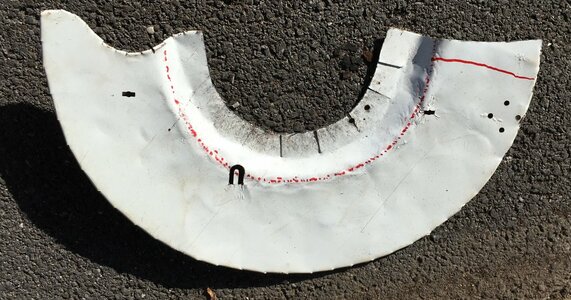

Below the replacement, made from the thin steel of a scrap light fitting.
And below again the shield fitted, I did this to both sides.
