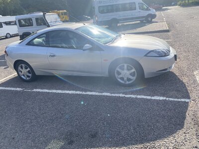

Hi Guys,

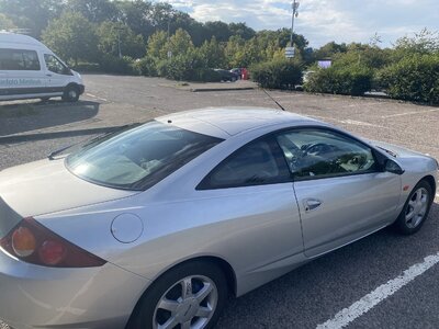

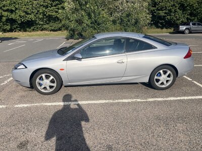

Dipped my toe into Cougar ownership just over 3 weeks ago. I remember seeing them when I was younger but then like most people I forgot they existed until I decided recently to get a second car for some fun that didn’t cost the earth which is where the Cougar idea came from.
I saw one for sale locally & after having a drive decided it was for me. It’s an X reg V6 auto box with the X pack.
So far so good with the first few weeks of ownership. I’ve sent it into a garage near me that’s familiar with working on these cars. I asked them to give it a thorough going over & unsurprisingly the 24 year old car has a couple of issues. Looks like I need a transmission speed sensor & some new parts on the front suspension. Finding these parts isn’t a euro car parts job so if anyone can help point me in the right direction I’d be very grateful.
Looking forward to getting it sorted & some god use over the coming years
Cheers

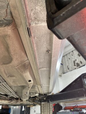

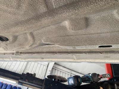

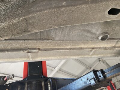

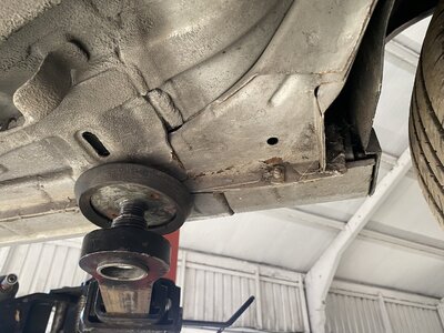

Well I collected the car earlier after a few days in the garage. Managed to see it up on the ramp & it’s pretty much rust free from what I can see. It’s clearly spent most of its 24 years in a garage.
As for the problems the list isn’t too bad….
1) The guys at the garage were unable to get the transmission fault light to flash at them despite bringing it out for a good few drives over the week. I’m hoping it’s just an electrical gremlin but to be sure I’ll try to get it along to a local auto box specialist for a check on error codes & possibly a reset (as suggested above) if she keeps intermittently showing the fault afterwards & messing up the gear changes I’ll get a speed sensor ordered up using the above link
2) I need new front lower suspension arms on both sides as both ball joints & all bushes are done for. The Ford part number for the right hand side one reads 97BG-3042-BA. The garage was unable to source new parts so if anyone can point me in the right direction it’d be very helpful
3) New belt for the alternator required
4) Fuel filler neck corroded
5) Front suspension top mounts are corroded & could do with being replaced
6) Annoyingly the washer bottle is full of muck so needs a clean out as the jets are blocked
Overall it’s far less than I was expecting. Hopefully get it all sorted over the next few weeks.

That does look to be very clean underneath. (y)

Underside does look very good, I have used both Bilt-Hamber and Lanoguard in recent years for underside protection and would recommend both if you fancy giving it another coat, they would prolong the life of the filler neck too.
Reactions: Mako
So that's what they're supposed to look like underneath! Yeah that thing is mint.
Do only the lower arm ball joints need doing? You can get bolt on replacement ball joints without removing the arms. That's what I did. General consensus is not to waste your time with that but my arms were absolutely fine so wanted to keep the genuine ones on as you can't get them anymore. Something to consider if it's only the ball joints.
To be honest all fuel filler necks are corroded. They're really solid metal so just clean it off and paint it, I wouldn't worry about changing that unless it's particularly bad. Considering how clean your car is underneath my guess is it'll be just surface rust.
There's a couple of other things you ought to do too to preserve the life of the car, such as checking the water pump and also removing the sponges that sit in the rear sills. Lots of info on the forum or post if you're stuck

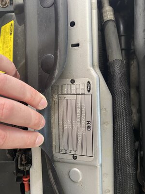

There are two different lengths of aux belt for the C1 V6 depending on build date.
The engine build date is on the label on the rocker cover nearest the front of the car, on the end nearest the driver side wing. It is in the US date format of month - day - year.
Is the writing still visible on your original belt? It should have the part no. and size on it.
Recent water pump query here:
