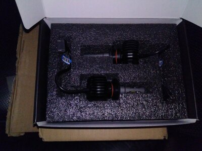

They arrived in the usual Amazon carton, two bulbs in the pack in simple grey polystyrene insert.IMG_20181106_182537.jpg

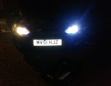

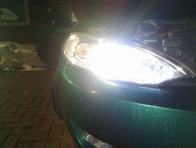

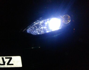

How the halogen/filament bulb looks lit.

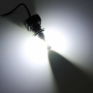

Then the LED
Both together for comparison.

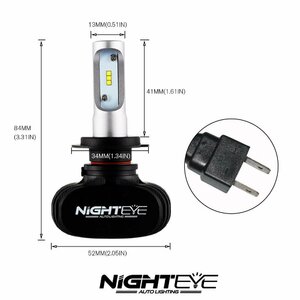

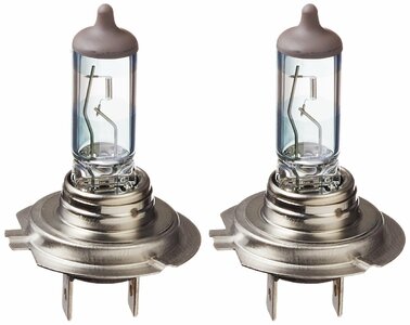

Supplier photos; I think the elements are pretty much where the filament would be and this influenced my choice.
Note the filament bulb has an opaque cap:

As to forward illumination, white light floods a decent-enough patch of road and up to tailgate lip level of the car in front, quite adequate for purpose (sorry it isn't more scientific).
What i did notice passing a car parked half-on the road, was that the beam didn't strike its reflectors, not a problem as I was in a 30 limit.
