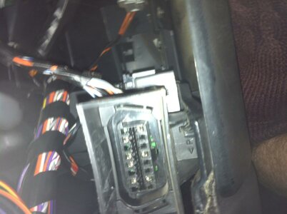

OBD-II Port
Pull the panel off beneath the steering column and it is to the right hand side (around where your right knee would be when sat in the drivers seat) :thumbsup:

Didn't want to start a new thread so thought i'd post in here. I got a lend of a MaxiScan MS300, Is this the port that i should connect it to ?
That's the boy. You might want to grab it from behind with your other hand when plugging in as it has a habit of popping out of its mounting :rolleyes:
