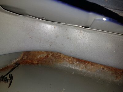

So, after seeing matts car... I decided to take the rear out of mine...
This is the drivers sill...

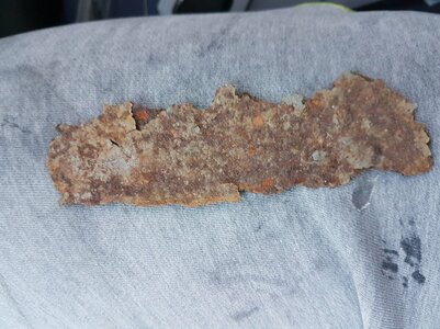

Theres alot of loose rust there I mean here is a sample

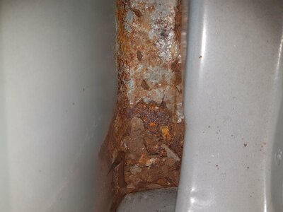

There are signs of previous repairs...
What is my best option now?...
It's not the end of the road. If it was, Tiger would've died years ago.
Tap the outside of the sills with your knuckles and listen for hollow noises. If so, tap with a pin hammer and see whether you go through.. Made a hole now? Don't panic - it's just metal.
Didn't make a hole? Take out the rear interior and remove the sill liners underneath the doors. Now inject all of it with underseal. Failing that, dirty diesel oil.

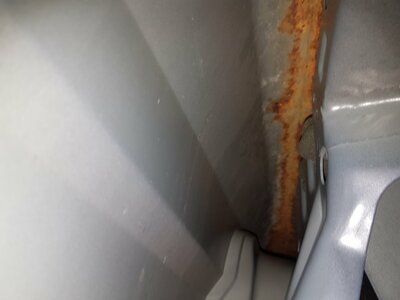

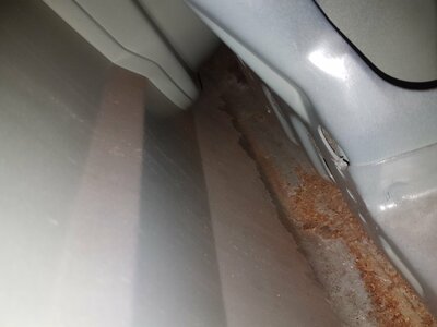

This is the nearside
Doesnt look too bad down the sill but im not sure about that corner near the Arch..you might need the welder on that looks like the ingetrity of the metal may be gone , nothing that cant be fixed though
