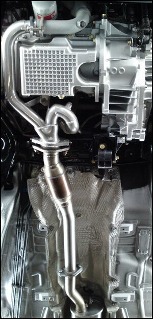

Does anyone have good photos of Racebits headers installed - as near to directly underneath the car as possible would be ideal.

That's perfect. Thanks!
You can see that horrible bit I want to eliminate right there! Just need to get under mine and measure where the c/l of the transfer 'box and propshaft is relative to the bellhousing flange now. :)

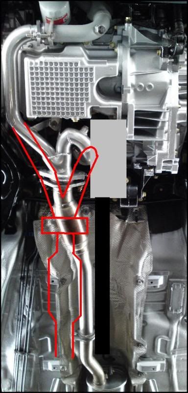

I want to do something like this - but I need to establish exactly where the grey and black blocks (representing the transfer case and propshaft) actually are.
