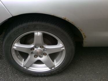

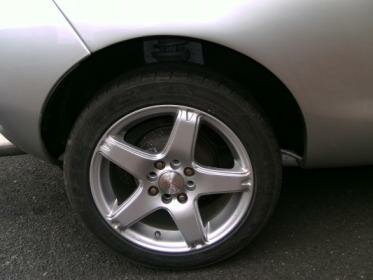

Anyone who has ever had anything to do with Ford's baby cat knows the rear arches are the weak point on these cars, in fact it's getting hard to find a Puma now that doesn't have rusty rear arches.
Having bought one ourself recently I've been spending a bit of time over at ProjectPuma, and have discovered that the guys over there have hit upon an ingenious solution.
Like our Cats repair panels are largely unavailable, and whilst our cats are nowhere near as bad, some of our rear arches are also starting to feel the effects of timworm...
So the answer some of the Puma guys have turned to is to cut a section from a Peugeot 206 front NS arch to repair a rear OS arch, and vice-versa, which I think is damned clever!
some pictures...

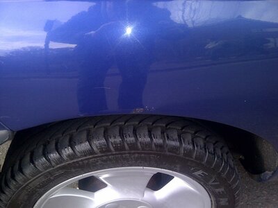

90% of Puma's have some rust on the rear arches and several have used Peugeot 206 front wings to do so or just cut in new metal
Mine had two little bubbles on one wing when I got it and they are still there now and no worse at all - mind you I always kept it well maintained and washed and waxed weekly!
