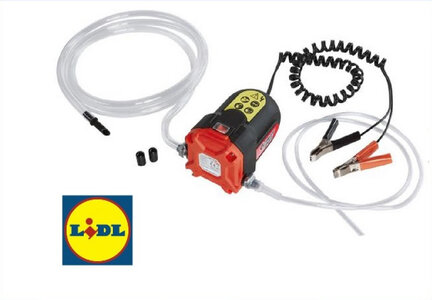

However, some time ago I acquired one of these from Lidl, it was £12.99 I believe. They still appear on the shelves from time to time. I think I posted about it somewhere, but can't find that either ( I was less careful where I posted in those days and trying to improve ).
To get to the last drops in the sump, I have used a length of copper brake pipe I straightened in the time honoured way in my vice ( brute force - pulling, slide hammer and then cutting the ends off ). I measured the output with a graduated jug and was happy that I'd got most of it.

The suction pipe on mine is a much harder plastic than the output pipe, more like vacuum pipe so it doesn't collapse. That makes it easier to manoeuvre, but its bendy and tries to go its own way, i.e. stay curved as it has become from being packed in the box. I joined the brake pipe with a short piece of silicon pipe which I think came off my daughter's violin rest.
Are you sure yours is not just failing to prime over that distance ? Try feeding it a bit of clean oil to get it going...
