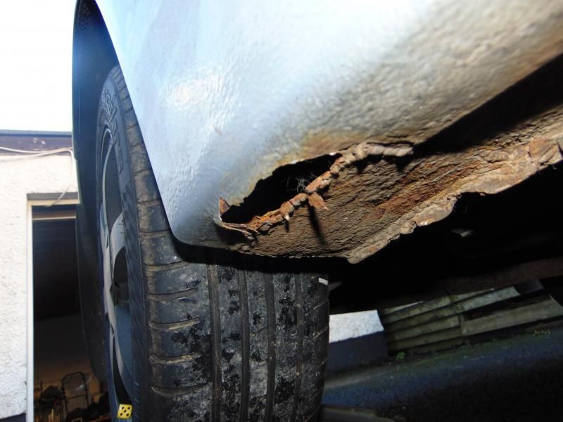

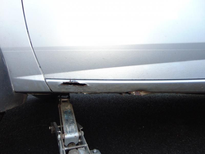

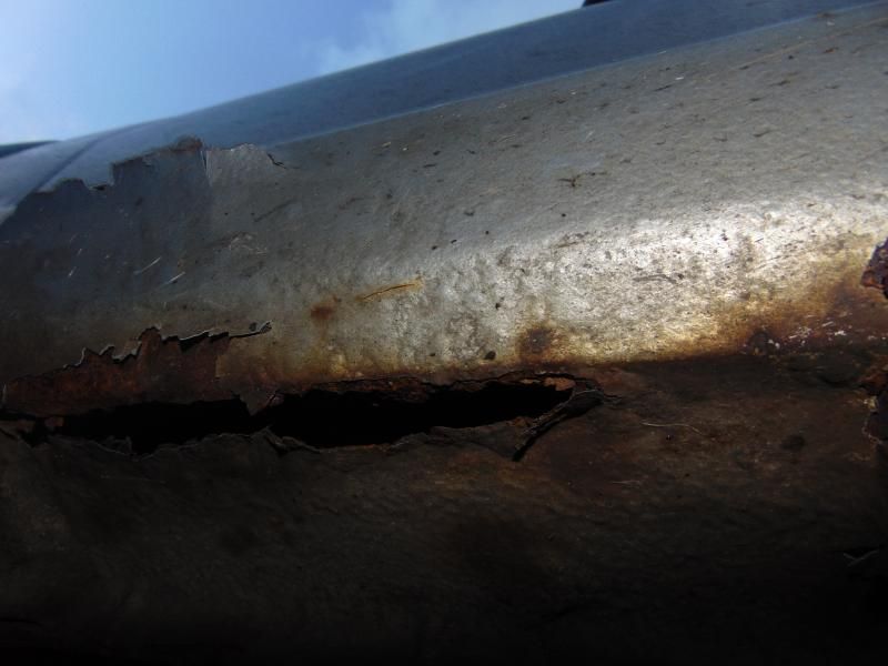

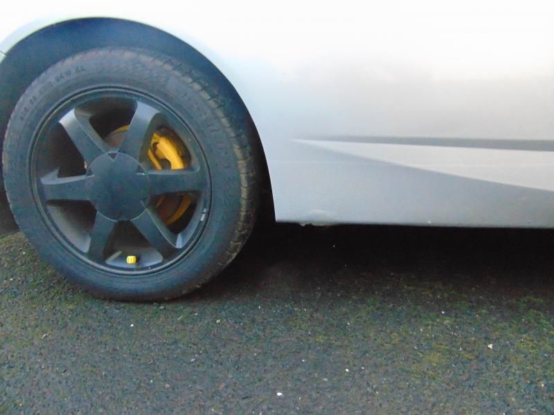

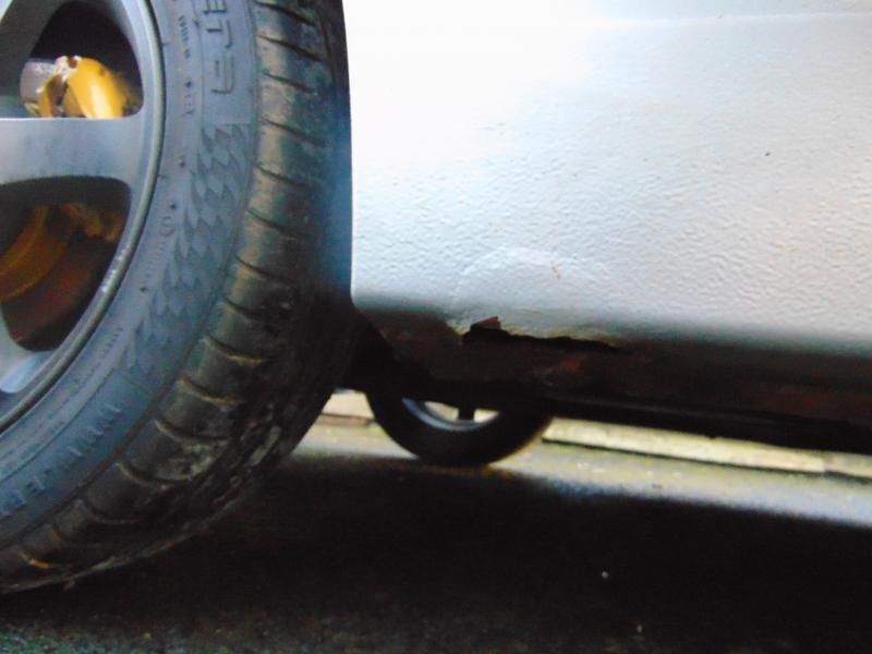

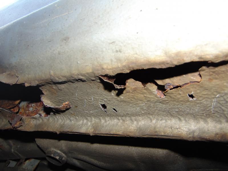

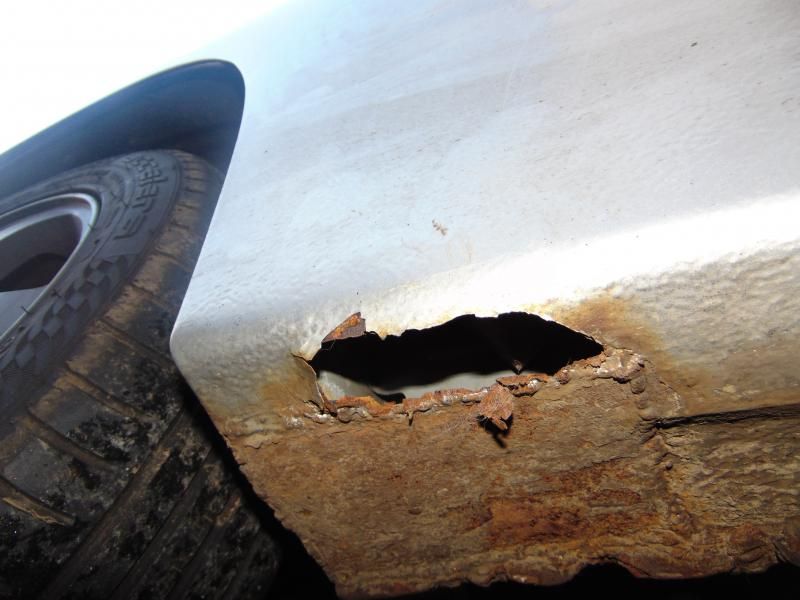

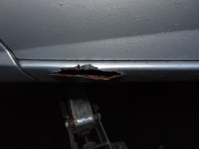

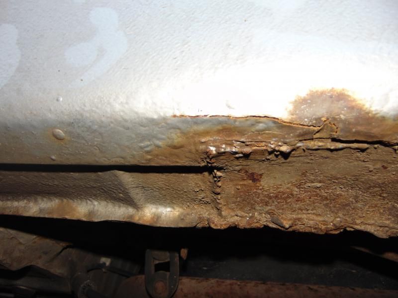

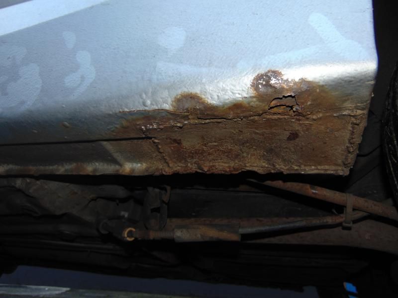

As promised here's some pics of the damaged sills, if you could give me your opinion on the extent of the damage and how much I should expect to pay to sort it.
Driver's Side
Passenger's Side
Oh hell. That's been welded up before and not correctly treated (last two pics).
I won't lie to you - that's in a very bad state. I'm not a welder myself but I've watched them work - on my own car too, no less - and what you can actually see is not what the actual rot really is.
I love Cougars, I really do. Possibly to the point where it's unhealthy. But I am going say right here and now that unless you have an emotional connection to that vehicle and want to shell out at least £600, part it out and scrap the shell. It's beyond economical repair in my opinion. The nearside damage is simply catastrophic, which is largely what's driving my response.
I'm very sorry.

I agree with Chris, it'll cost more than the car is worth to put that right. I certainly wouldn't fancy a go at that and i enjoy a challenge.
sorry :-(
Seeing the pictures, I have to agree. Anything is fixable with enough time, money and work, but you'd be most of the way to a replacement Cougar in reasonable condition for what this would cost to sort. I hate to see Cougars die, but you'd have to be seriously attached to this one to bring it back to health.

This is one of those times where I really, really hate being right (and validated by someone who actually knows what they're talking about).
I don't think it's a case that it can't be fixed. I'ts just that you'd be on a hiding to nothing. It's sad, but... best to be realistic I suppose.
That's doable but you need somewhere that specialises in classic car restoration.
As above though, there's a lot of work in that and you will need both sides of the car resprayed so it will cost a lot of money to do to any presentable standard that would last any length of time.
