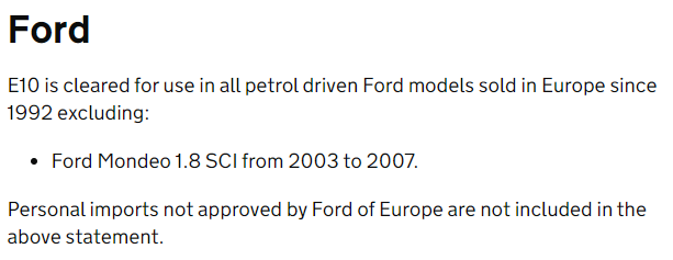

The government have an E10 checker tool which states all Ford cars except a 1.8 Mondeo will be fine with E10.
Is there any guidance on whether our cars specifically can run on E10? Just thinking that making a change after 20 years of one fuel may cause some engine related problems? What would the likely damage be if we did?
