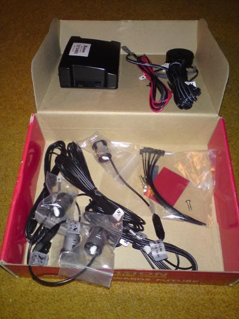

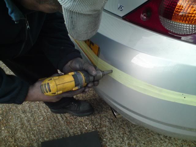

a week or so ago I purchased an X-Vision Parking Sensor Kit as used on the Fiesta, Fusion & C-Max.

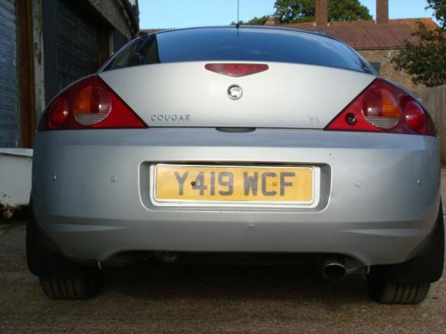

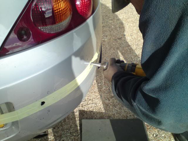

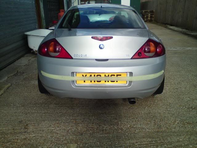

Sensors were already silver thankfully, so after studying various pics of Cougars with sensors fitted, I set about marking out where to drill....
Once happy with the markings, found an alternative to a cutter (that wasn't supplied) which was less agressive than a cutter anyway...cut it all nice and smooth.....and after a deep breath.....I bottled it so gave it to a mate to do lol

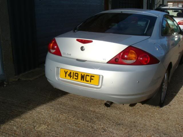

anyway, the sensors are in well-snug so all to do now is to wire it up
very pleased with them, just to wire up now......
the back end is a nightmare to judge so it;s put my mind at rest!

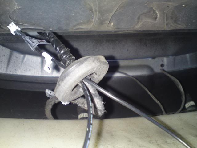

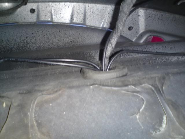

have just popped out and fed the wiring through from the sensors to the control box in the boot, all ready for the actual wiring up.
used the rear number plate light grommet as recommended, and all good.

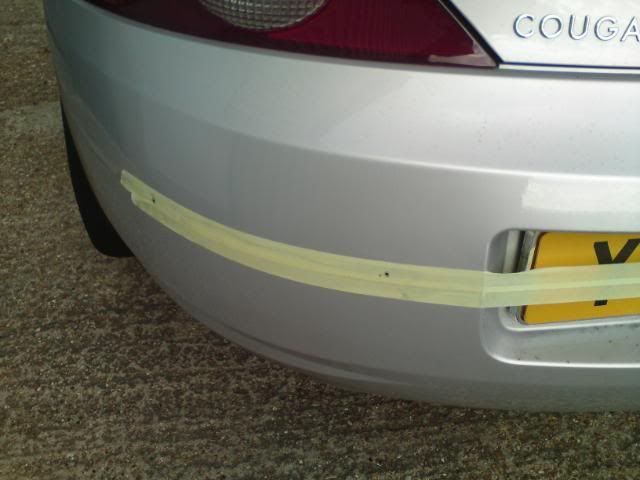

taped up loose wiring with proper loom insulation tape
