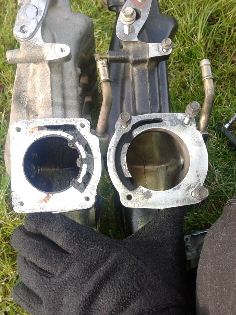

Here is a photo of the standard uim with the st200 one taken when i done mine. St200 obviously on the right. Are you planning to do the throttle body as well?

The photo is fine, There is a way to check which LIM you have, look between the gaps to the fuel rail, there is a plastic cover over the top of the fuel rail, if this is flat then you have the older smaller LIM, if the top of the plastic cover is rounded then you have the larger LIM, There really is not much point changing any of it unless you intend to complete the air flow from the air filter through the Throttle body then the UIM and then the LIM the decat headers and exhaust, a re-map will be needed after as you could well be down on power after all that too.
