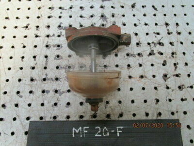

What it really needs is one of these off an old Ferguson tractor !

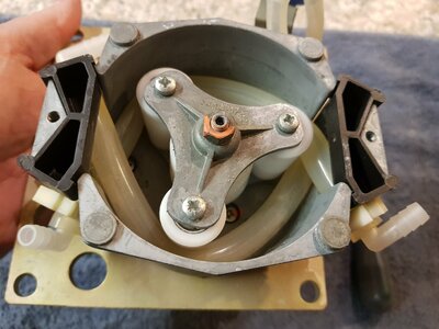

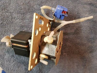

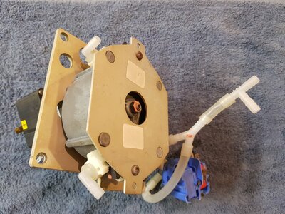

I have a smaller 'electric drill pump' like the ones you were looking at. I bought two at a boot sale and took one apart as it didn't work. It has a 'flap wheel' impellor, so I have to be sure to prime it and not to let it dry out in use ( the dud one had melted inside! ). I also have a 'peristaltic pump' out of something. Hopefully not out of anything hospital related. This just has rollers that pinch a replaceable piece of tube, so it can be used for anything and the tube replaced. I think the biggest problem would be getting past the antisyphon device in the filler.
If that can be done and it turns out to be a plastic tank, maybe a thin tube with a magnetic end could be manoeuvred using an old hard drive magnet, down to the lowest point. The garage also suggested using some RedeX injector cleaner ( half price in Tesco ? ) in the next tank. We're going to try not to drive it until I've done the filter at least.
While I don't have any firm data, (because I have no idea what you've got there) what you're describing is almost certainly a medical device with a pulsed delivery. Mrs. Mako had something exactly like that for pumping enteral food. It also sounds like something you'd use to pump blood through your liver.
Does it have any identifying marks?
It's a part out of something. I have a tendency to visit 'Radio Rallies' where ham radio ops and computer freaks buy, sell and exchange geeky stuff. I think I paid a £1 for it. I'll take a picture when I pass it next ( its at the far end of the cave ! )

That looks like an enteral feeding system.
All of it is held outside the body and gradually pushes Satan's salty milkshake into your stomach through a pipe inserted through a "port" in your upper abdomen. You might call it a "stoma".
Source: My wife had one.
