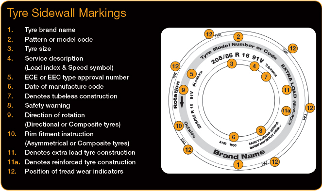

Call me thick if its common knowledge but i didnt know that tyres had a date code of manufacture on them
Tyres have a shelf life of 6 years when not being used the rubber of the tyre starts to degrade, its why you shouldn't drive on very old tyres and your spare should be changed every 6 years as well (this goes for both space saver and normal size).
