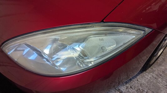

The headlights on my car were starting to yellow haze a bit.
I'd had them done when I had the car painted in 2023 (not cheap!) and with the impending MoT, I thought I'd give this kit a try, mainly as a balance between price and ease of use.
I'd read mixed reviews especially with the seal not improving clarity.

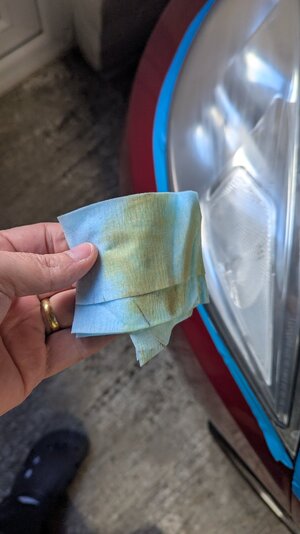

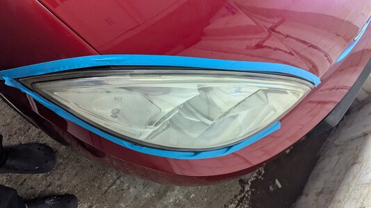

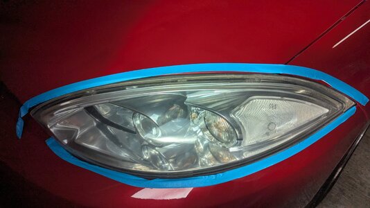

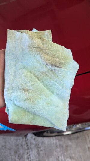

Clean the headlight(s)
Using one of the two wipes, wipes across horizontally, folding over when the wipe get dirty.
Allow to dry

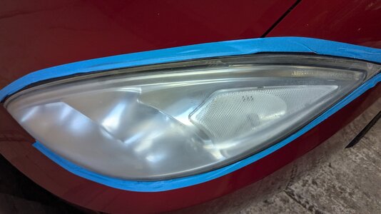

The use the sealing wipe.
Yes it's that simple.
I left the seal to dry overnight.

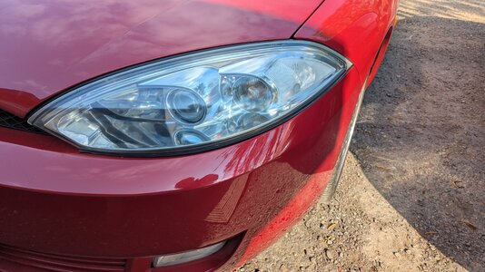

Not a bad result. If you're looking for a quick result then it's ok.
3/5 overall

Wow Tiff. they look really (surprisingly) good. I took my lights out of the car flatted using various types of wet and dry, then cemical wipe, then heated up before applying 2 new spray coats with 1/2 an hour drying time between and my lights didn't come out much (if any) better!
