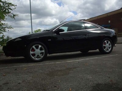

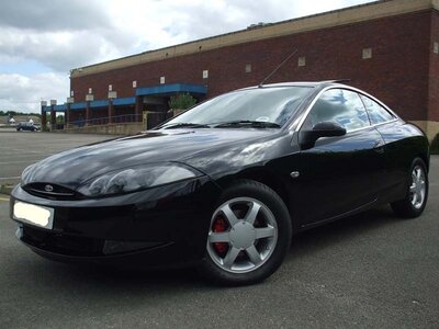

The reason being the cats black again... ive spent the last 3 days detailing her.
When I first got her there was mould growing on the paintwork and mould in the interior plus all the usuall swirls, scratches etc that you would associate with an 11 year old car:

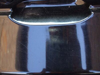

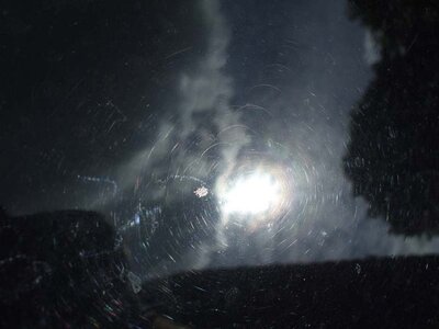

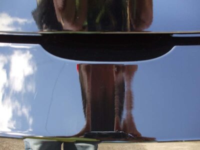

Ill let the pics tell the story :

What products/ equipment did you use to clean it?
Thanks mate, first I rinsed,foamed then washed. Then went over the car with a clay bar and then dried..... next I used a das 6 polisher with a lake country cutting pad (thanks Paul/shagmonkey for the tip) with menzerna power gloss polish, menzerna power finish with a menzerna medium pad, then auto glym super resin polish on a menzerna finishing pad, then 2 coats of colinite 476s wax... and that was just the outside lol
