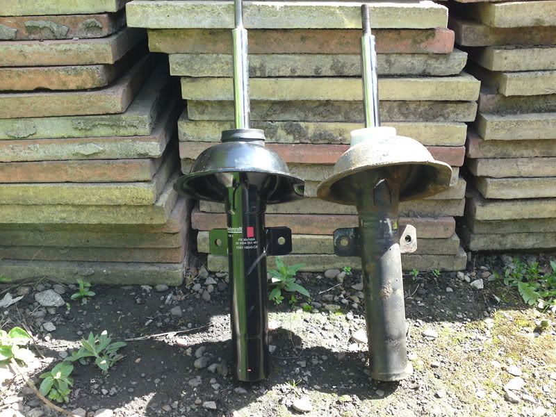

Fitted brand new ford front shockers.
New and old:

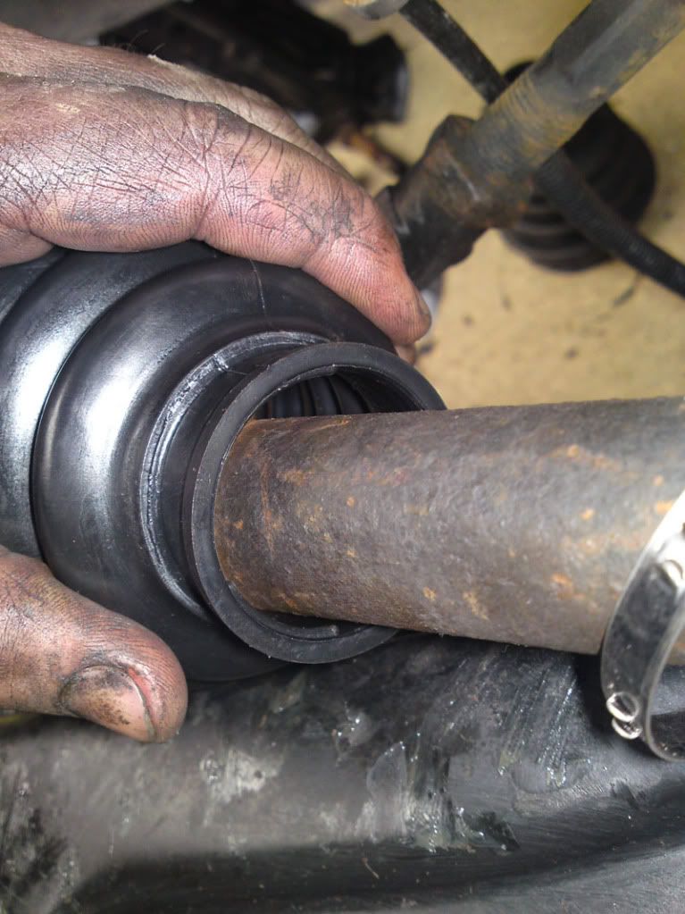

Fitted new cv boot cos the 6 month old one i fitted before had split.

New shockers are a vast improvement..went for a test drive and was actually looking for potholes to drive over..no more crashing and clattering:D

Nice job mate. CV boot split after 6 months??
Yep..it was one or those universal ones that you trim down to size..really thin piece of rubbish really. New one is a lot better thick stuff..well the second one was..the first i was given was the wrong one..too big:
