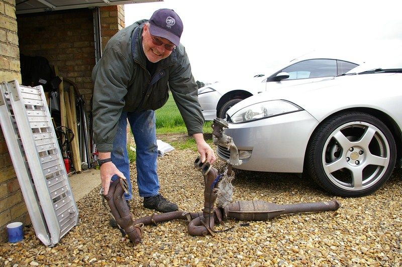

Tony's new MSDS headers and a Mondie main cat :)

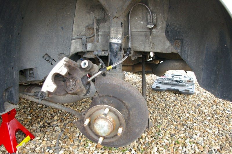

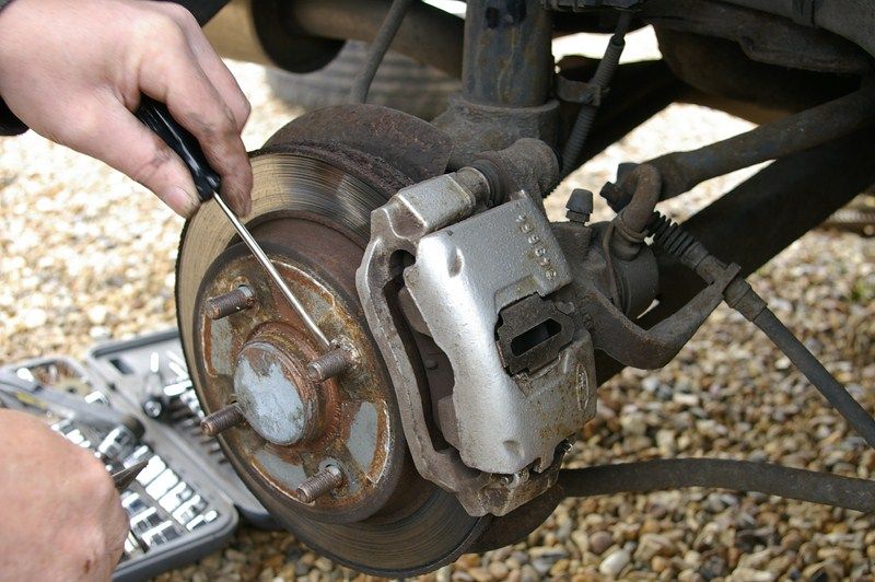

Work begins on stripping the rears and fitting the new braided hoses

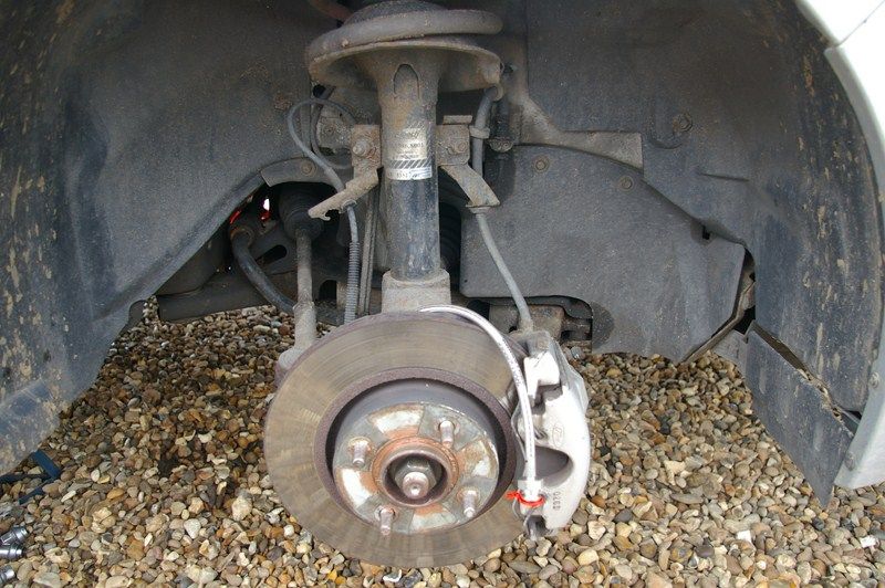

Fronts before being stripped

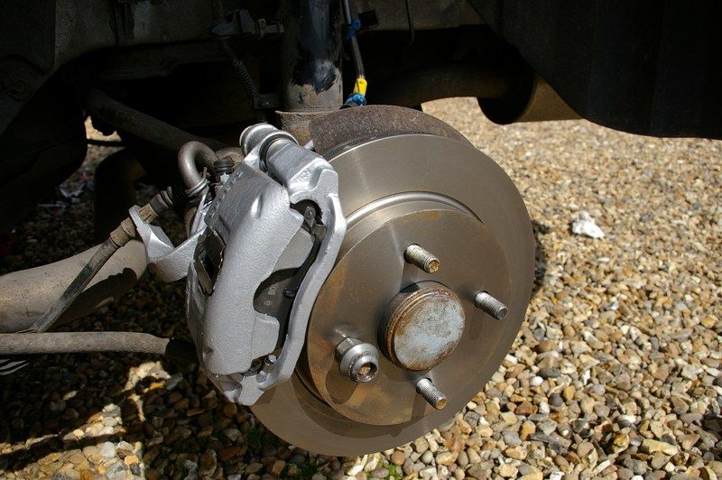

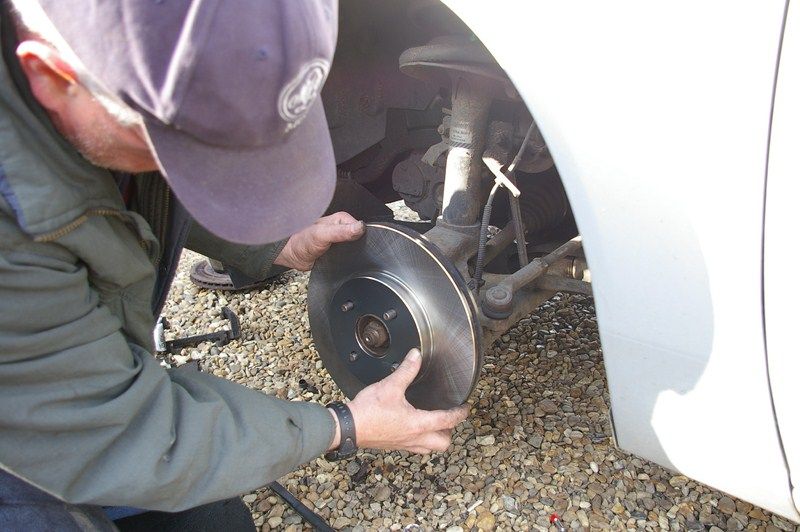

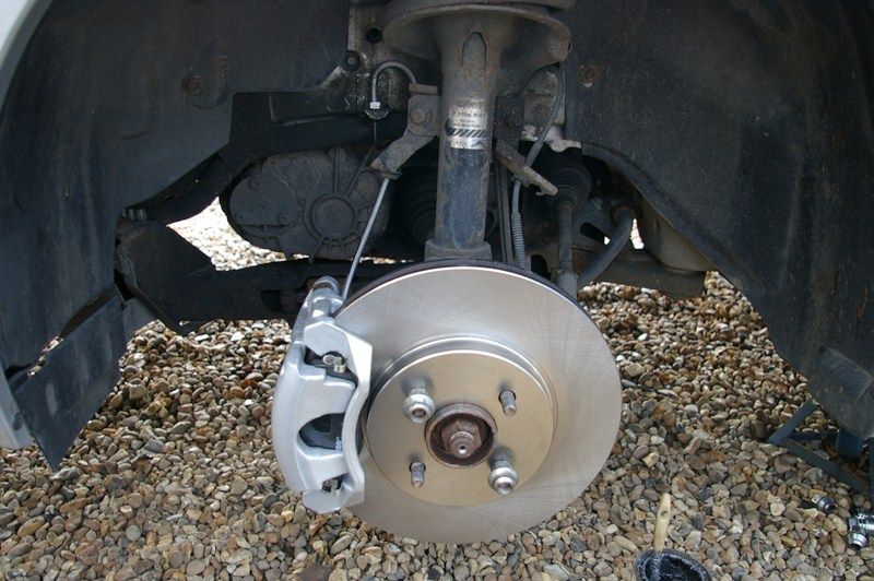

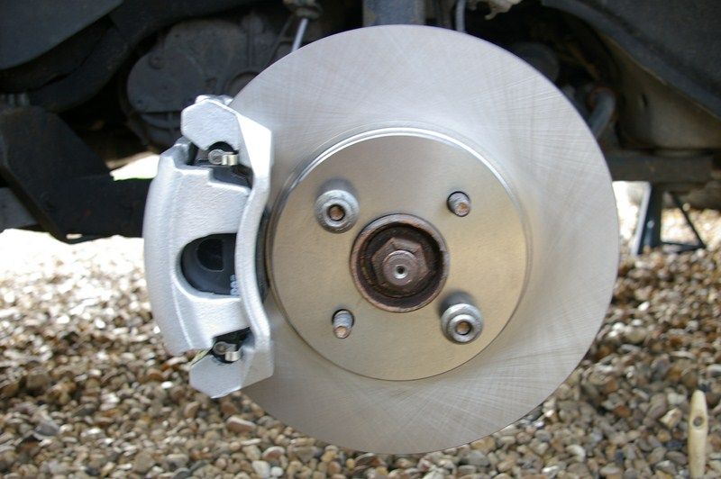

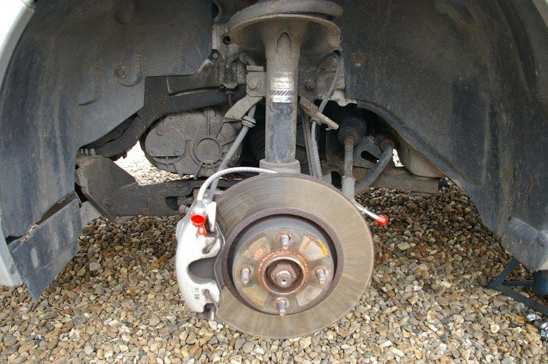

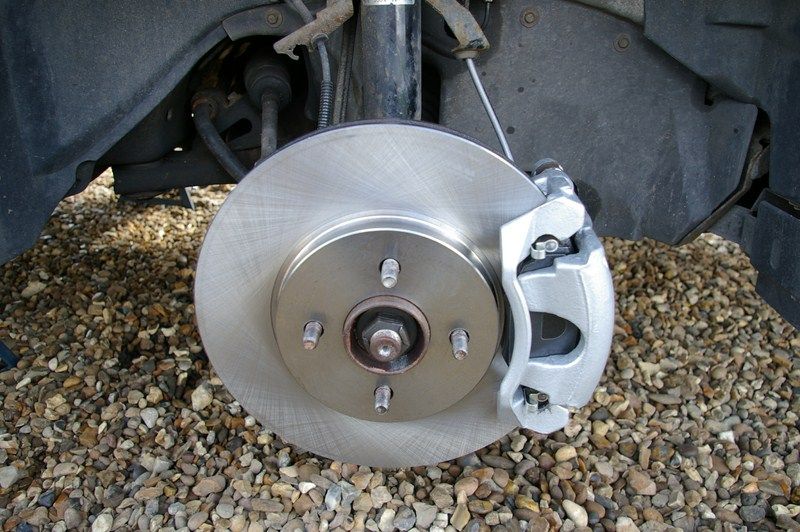

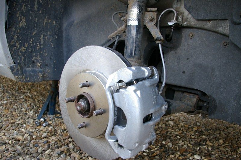

Fitting new ST170 discs (Lockheed Delphi) and Mk3 calipers to the fronts
Front right fitted

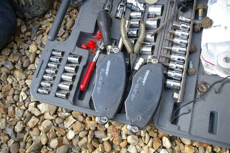

Ferodo Premier Mk3 Mondeo pads
Front left Mk3 caliper ready to fit

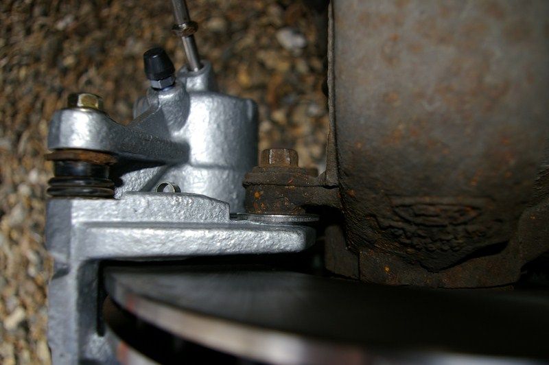

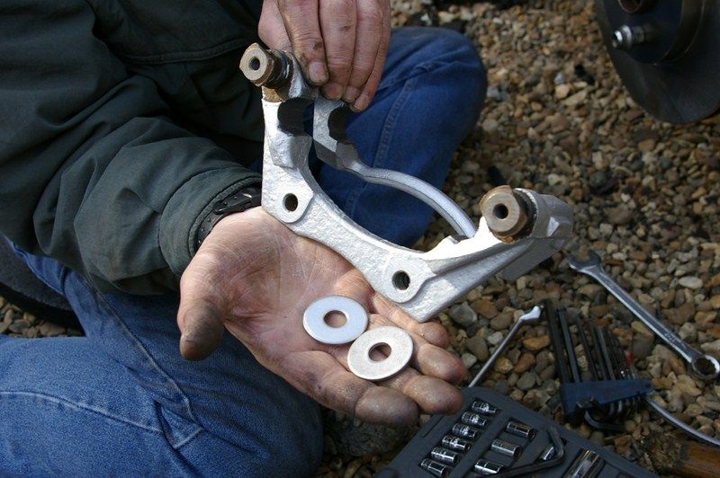

And the carrier with A2 stainless 3mm thick washers for spacers

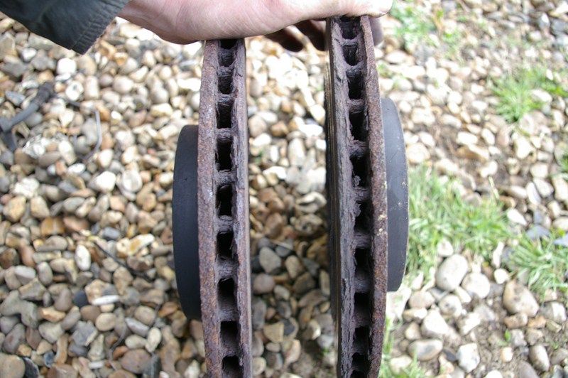

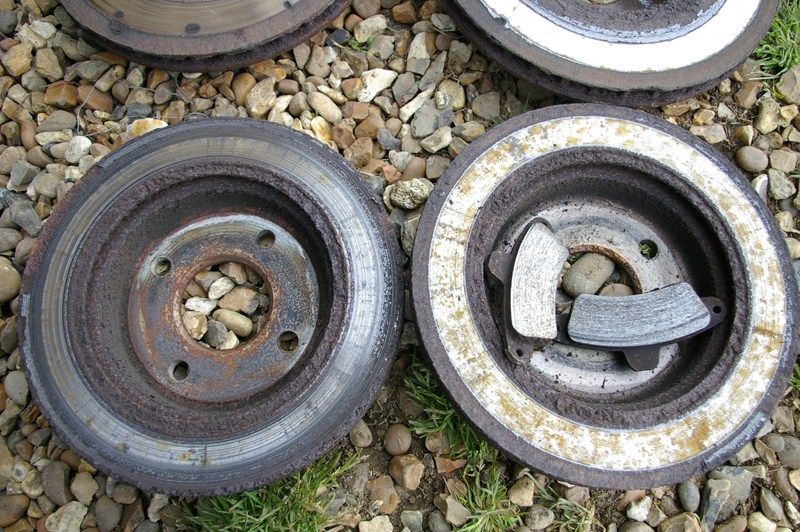

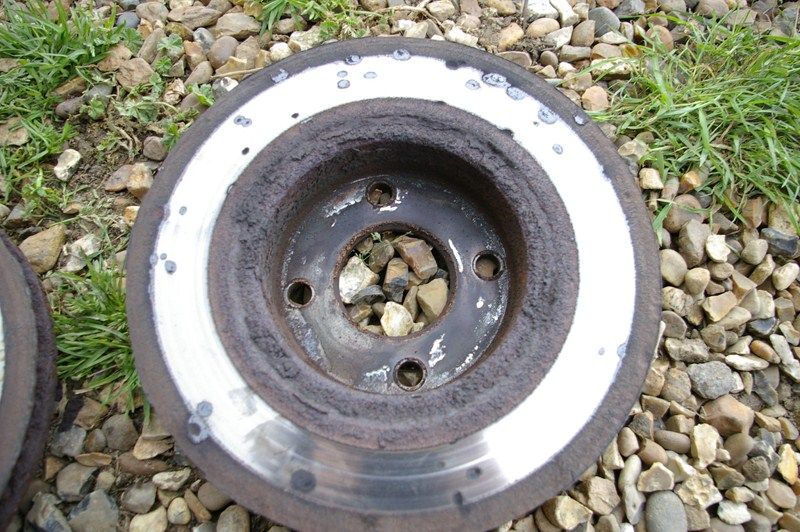

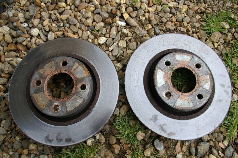

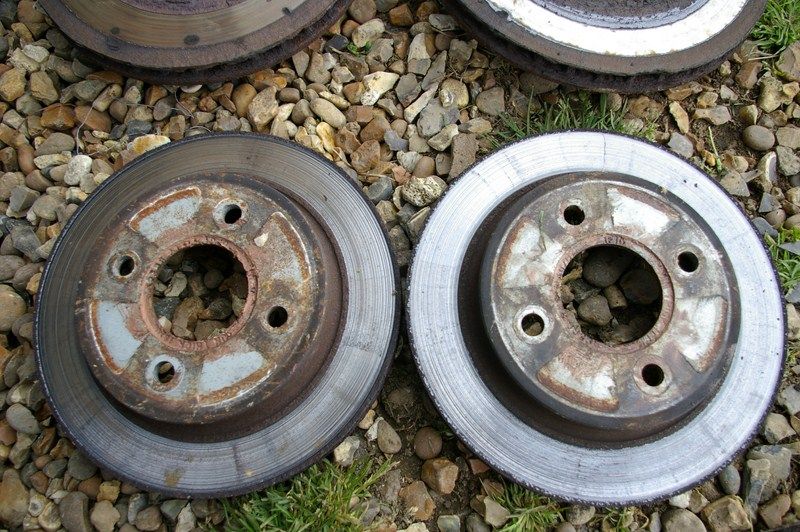

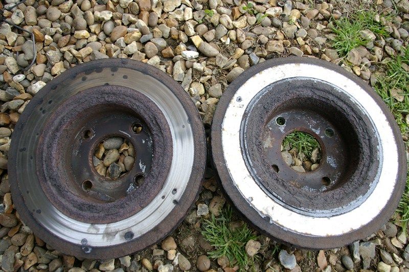

And now for those old shocking discs
Outside rears
Inside rears

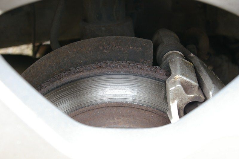

Outside fronts. Don't look too bad do they?
Inside fronts. Totally fubard!!! :eek:
Yes that's pitted!!! :eek::eek::eek:
And look how worn they are on the inside!!! o_O
I cant't complain because they've given me and the previous owner good service.
As far as I know, these are the only set of front discs the car has ever had.
The previous owner kept all service and repair receipts and there was nothing to say they'd been changed.
They passed the last MOT in September but there was an advisory that they were corroded on the inside and needed changing soon.
They're 11 years and 85000 miles old!!! :LOL:
Left front assembled
Washer spacer in place

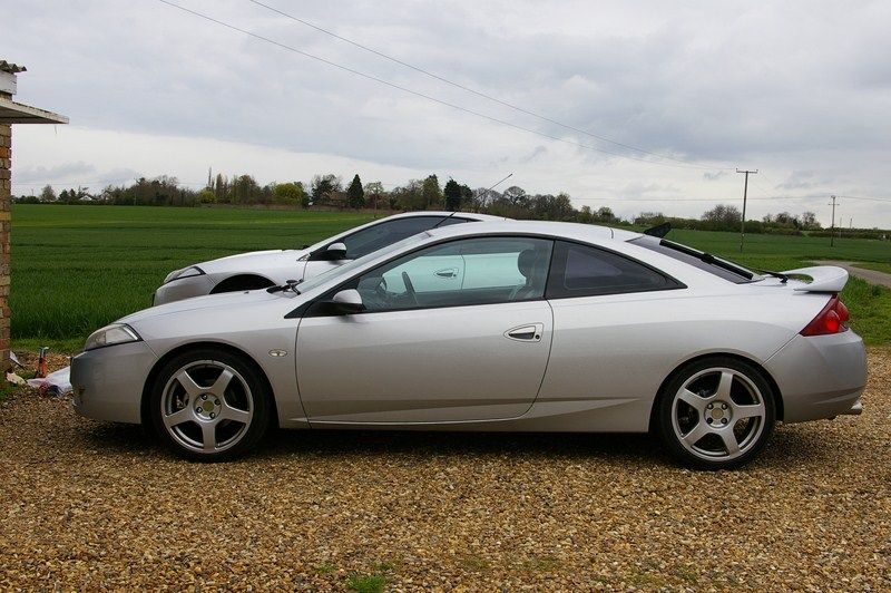

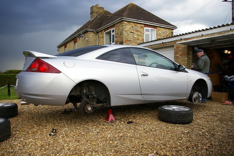

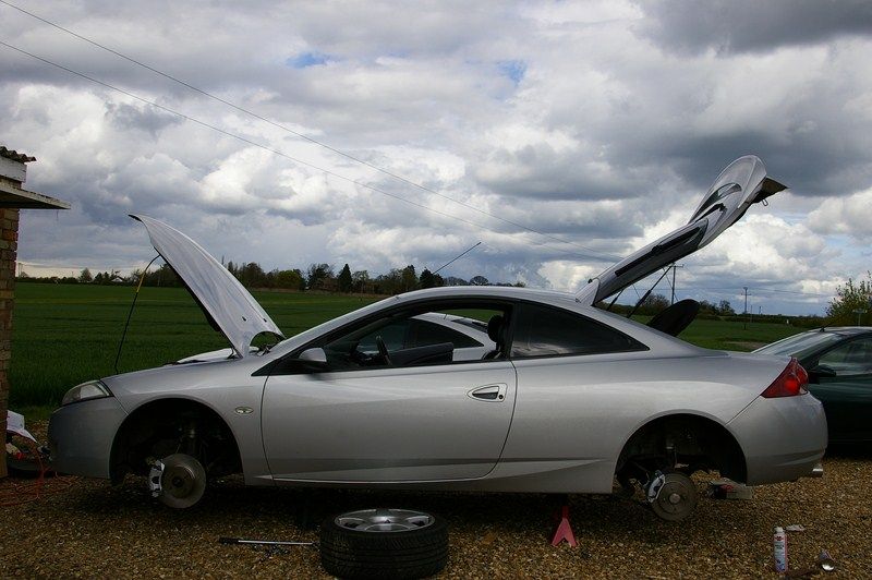

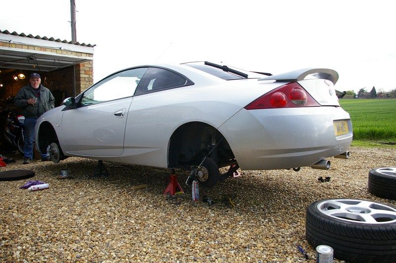

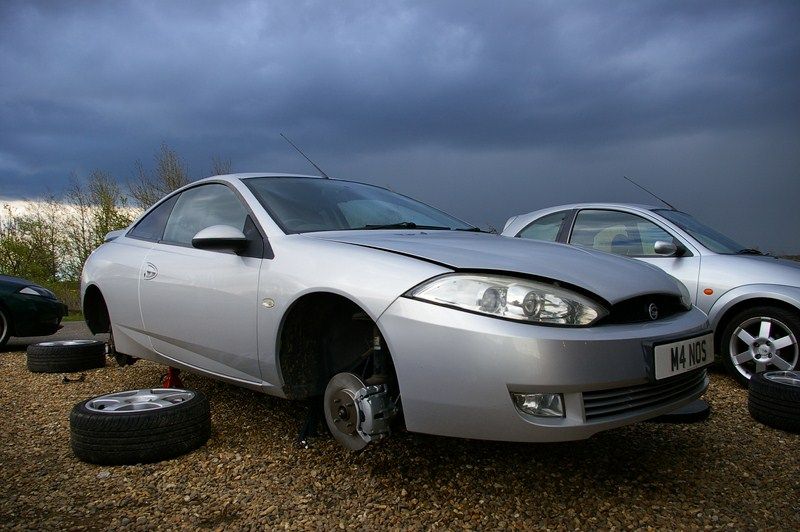

Some nice pics of my car on stands
Put ya tongue away Tony! :p

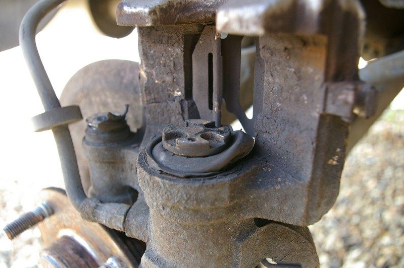

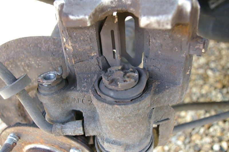

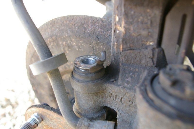

Discovered the right rear caliper rubbers were shot, but not leaking.
Fortunately I had some refurbed rears at home so I borrowed the Green Goblin and collected them.
When I returned I gave them a lick of paint so they matched the fronts and left them to dry overnight.
So onto Sunday and the rears were assembled.

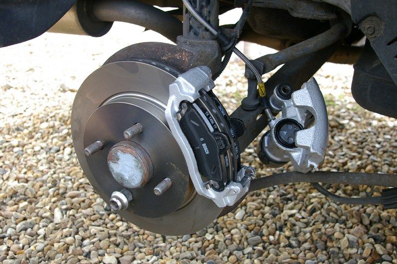

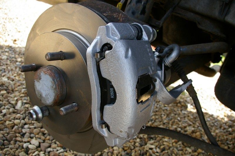

Right rear with Lockheed Delphi discs

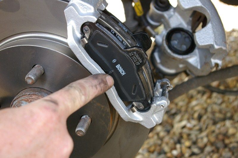

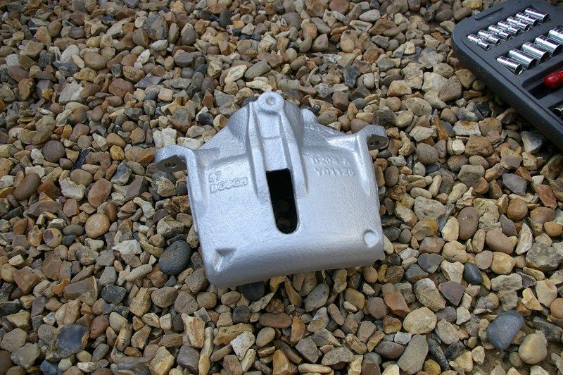

Genuine Ford pads but on peeling the film off we discovered they're Bosch's
Left rear

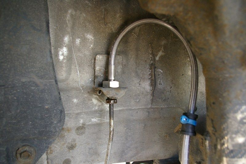

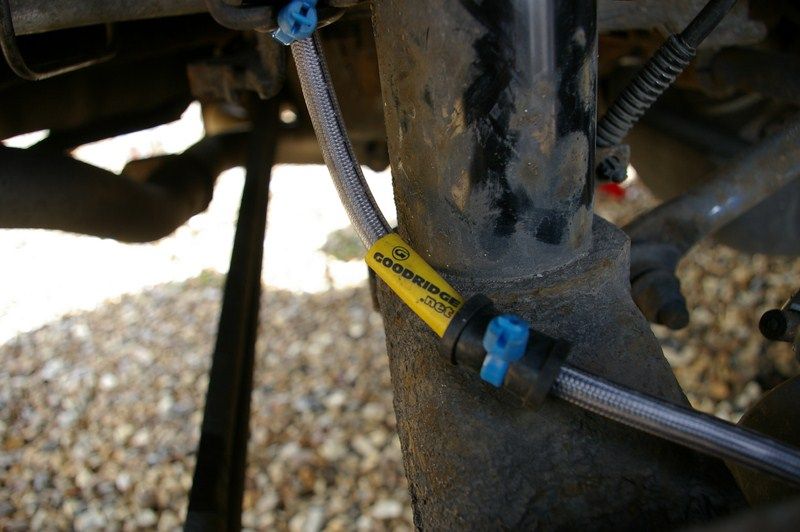

Goodridge braided hoses
With SS fittings

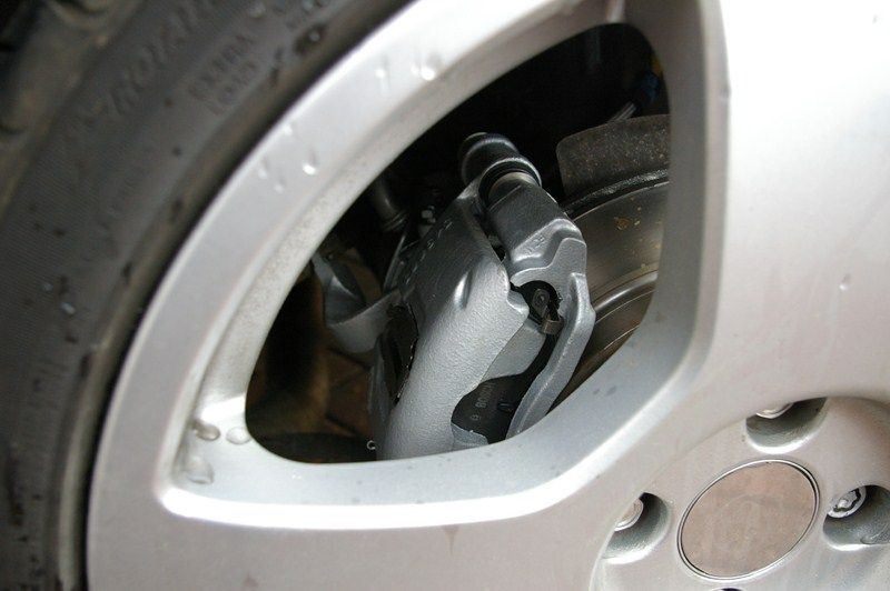

Ready for bleeding and some wheels

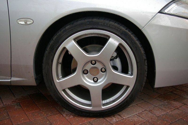

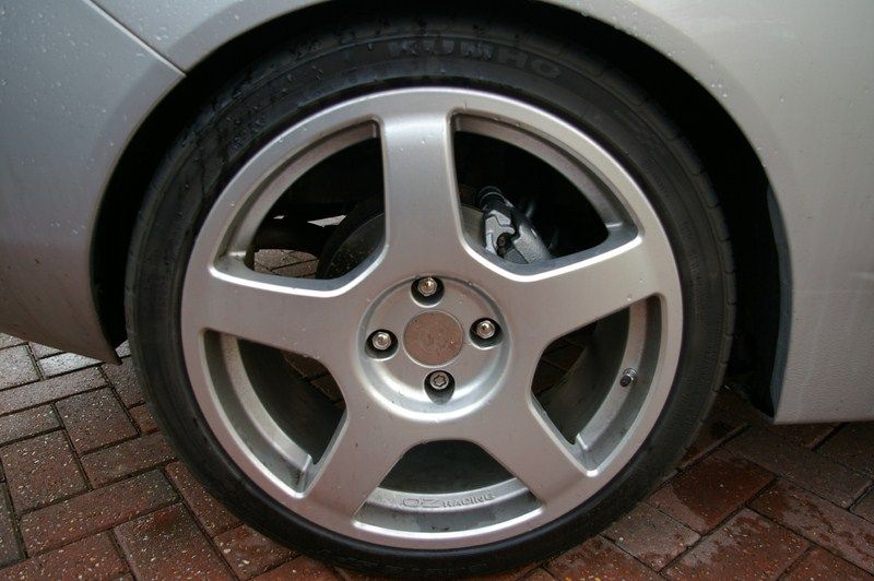

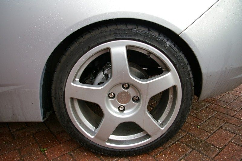

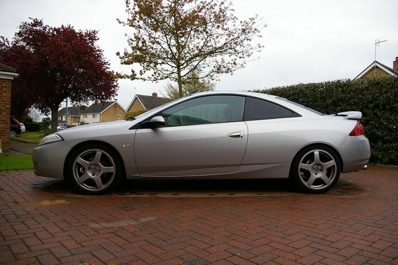

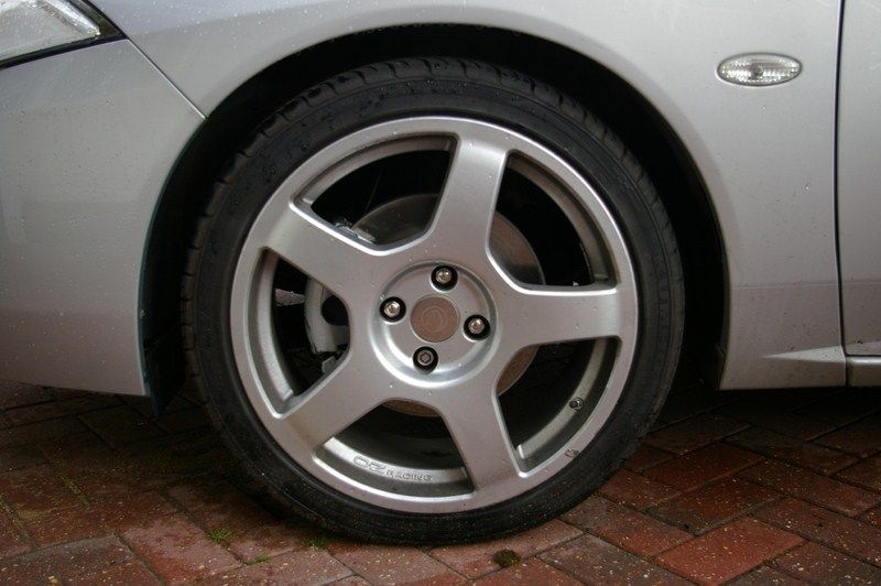

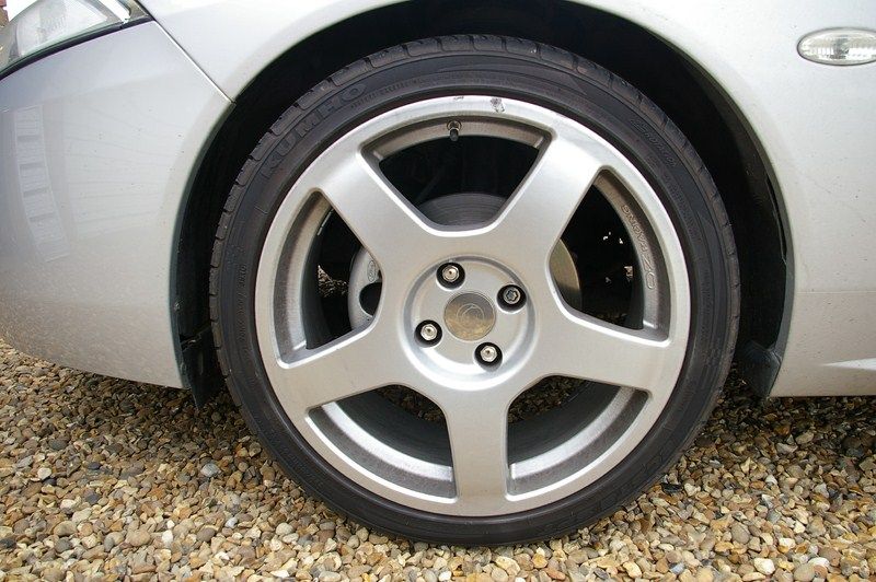

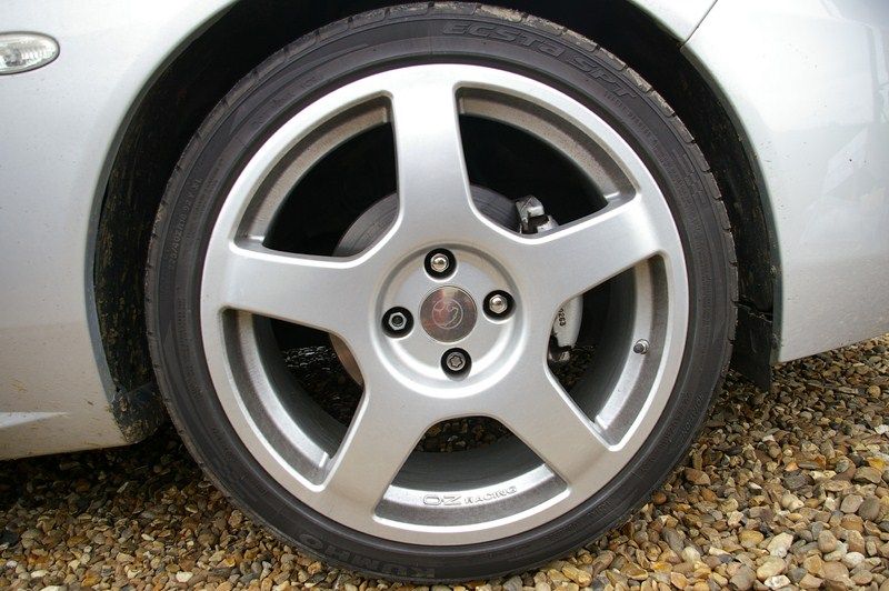

After road testing it started raining so these 'after' pics are taken at home
Many thanks to Tony for all his hard work and expertise. (y)
Paul was there too, mostly under his car fitting his knock sensor and main cat.
Just waiting for them to bed in now. Although the pedal is a bit spongey, it really does stop now and without any vibrations.
As Tony mentioned, the rears may need re-adjusting as the handbrake needs a few more clicks now.
The handbrake does work though, I tested several hill starts today with no probs. It held the car nicely with the clutch at bite point.

Those pitted discs are shocking - almost as if something has sprayed onto them (maybe whilst they were hot?). New discs look so nice - a shame they turn to rust so quickly :(
