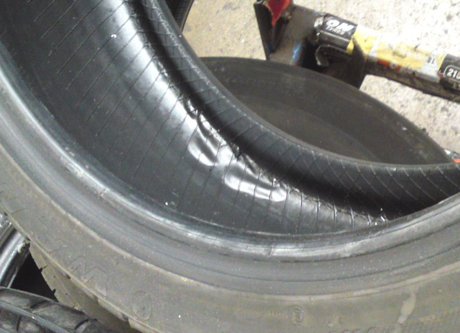

This is a WanLi 225/40/18 as fitted to Tiger's offside rear by - presumably - the previous owner. It had plenty of meat on it, but was catastrophic in the wet to the point of dangerous oversteer, so I was looking for an excuse to replace it. And boy did it give me one - at 75MPH on the M1...
In case it isn't obvious, what you're looking at there is the inside of the tyre, with a large section totally delaminated.
My tyre guy said that he sees this all the time now with some far-east tyres. He added that the grip issues I was having are common as well; the rubber seems to deteriorate and harden in the sun's UV long before you can wear them out so it's like driving on a cheap pencil eraser.
Indeed.
I forgot to mention that the outside of the tyre showed no sign of this. I'm guessing that the air escaped through the various cracks that had formed in the carcass over the years... So calling it a "blow-out" is a bit of an exaggeration since the running surface and walls were intact and it didn't spit me off the road. That's about its only saving grace.

I think the low-profile nature of the tyre helped because of the lower deformation of the sidewall. If it'd been one of Mako's standard 16s it probably would've been very unpleasant.
