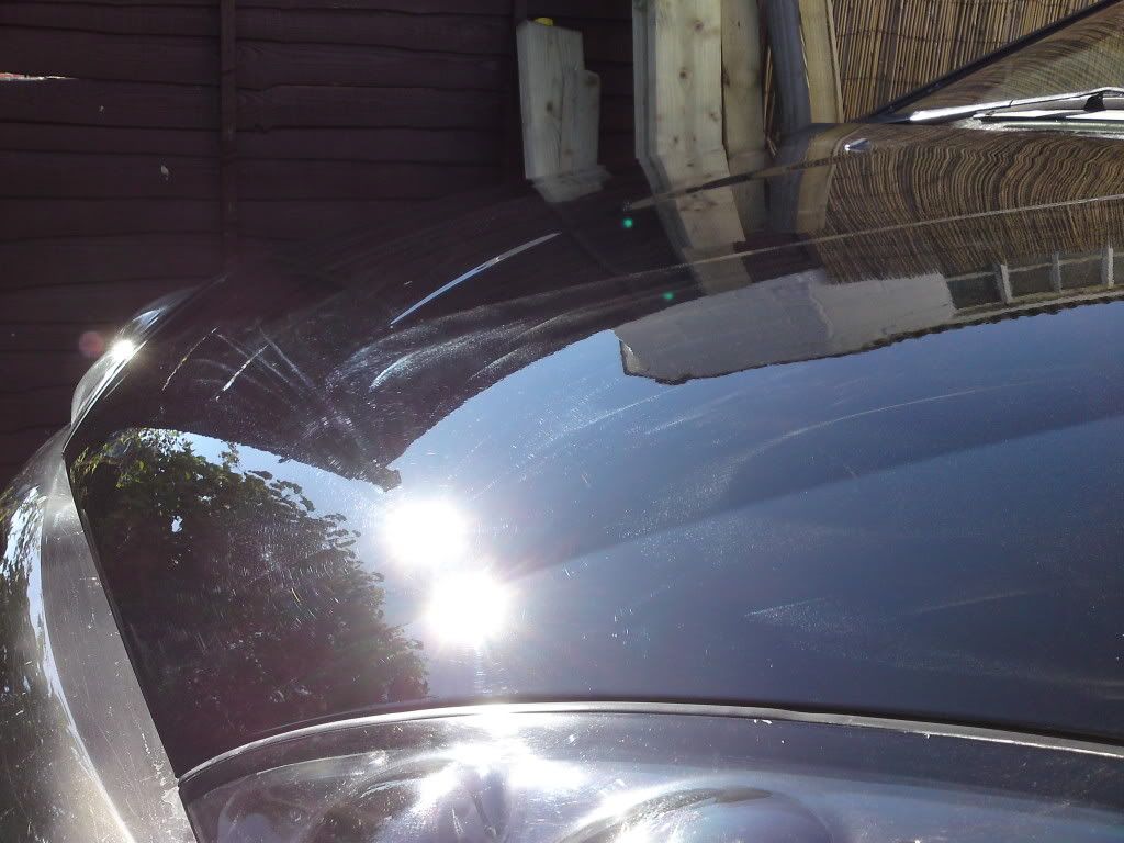

This is how the car looks now. I did wash it when it came home and whilst the bonnet is much less orange peely, whomever had machined it had clearly let the power cable drape over the bonnet as it was riddled with scratches. I didn't take any photos of these (I should have done) as I just wanted to crack on and get rid of them. I have got rid of about 85% of them by cutting back the bonnet in some areas 8 times !!!!

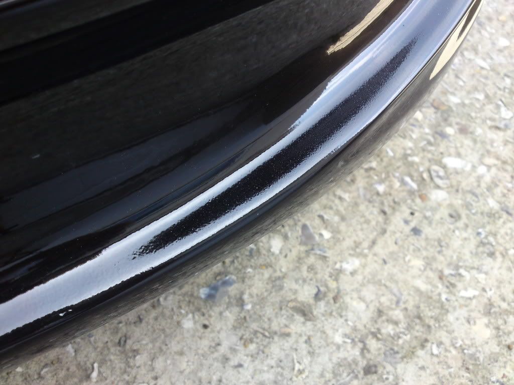

Front lip
So..............................seeing as I seem to attract **** garages no matter where I go, it's down to me to rectify !!
I started with a chip that the previous owner had touched up, and had done so VERY badly. It was like a wort on the side of the car!
So out with the wet and dry...bit tricky as it was on a crease line but who dares wins and all that! lol
Then onto some cutting with the DA
Overall, I would say 95% better than it was. Could have had another go with the wet N dry but for a daily driver, it's good enough for me.
Onto the front lip. Again, not a flat surface so a nightmare to machine polish. Doubly so as my small compunding pad gave up the ghost when I did the Audi and I haven't got round to buying a new one.
As you can see above, I haven't got a uniform sanded surface, but TBH I was just playing. I will do it again (and better) once I get a new spot compounding pad.
Still managed to achieve this however after just 1 pass.
Front lip
