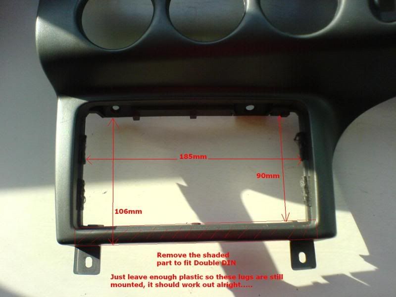

Does anyone know where to get an equivalent kit to this guys in the UK? Or is anyone willing do the cutting and modding to my dash to make a double DIN unit fit? I am a subtle as an anvil and will royally screw up my dash ;)

Mate I posted a pic up a while back of the amount of dash trim that has to be removed so you can fit a Double DIN unit into our dash, its just a case of cutting the HVAC pannel then the unit should fit.

Ginja you bloody legend!
Im meeting up with nickm tonight to pick up a new centre console and door card for mine (the previous owner has left fag burns all over them) so the new ones will go in and the old centre console that i am removing will get chopped so if i make a bodge job of it i dont have to worry ;)
Obviously if i do it right expect to see a thread on here...
Rob
9,273
405
Always glad to help. If you cut it like that, the dash trim they give you with the head-unit should fit and it will look flush (OEM style) just try to keep them lugs at the bottom as they hold the panel to the dash. Some of the newer cars still need adpator plates even if the space in the dash is Double Din, the Focus & Mondeo spring to mind, both Pioneer and Kenwood need special kits to get them to fit flush. I was in the markest for a Double DIN when I got my system fitted but the fitters were worried it would look a bit of a bodge job so advised against it....then everyone started fitting Double DIN units and there looked like there wasn't any problems (except for realeaving a bit of the under dash so you could actualy push the unit back into the hole) and after spending £500 on my head-unit I wasn't about to change, but who knows there is plenty of life still left in the old girl ;)
