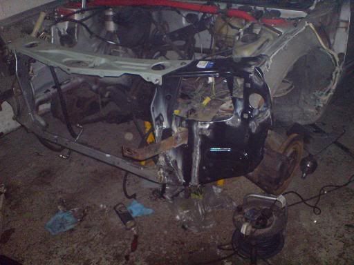

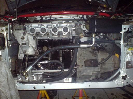

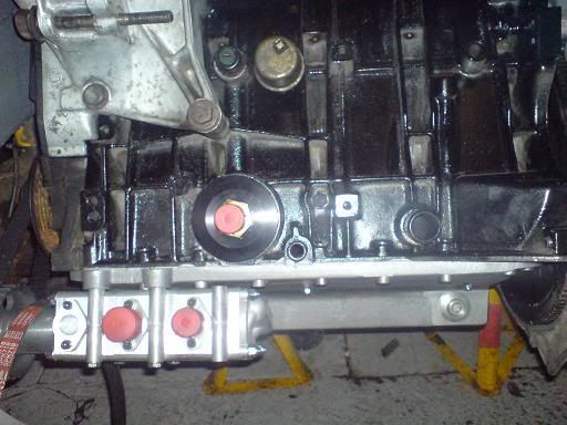

Well its taking a while but getting there. I wish I could say this is all my own work but this rebuild is well beyond my capabilities. Engine ripped out and scrapped, only bits salvageable is cams and timing cogs!

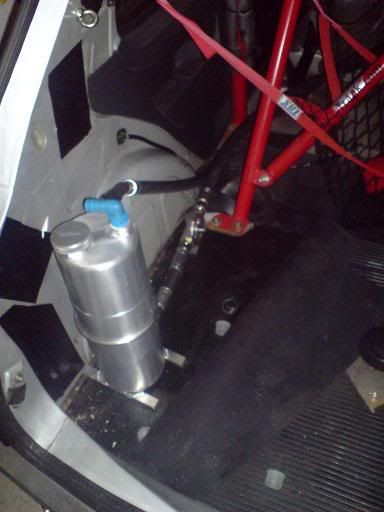

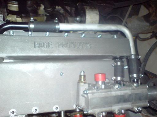

Managed to source a good block and the rest is new apart from a reground crank. All other internals genuine Peugeot items. Pace dry sump is the equipment as was used on 405 BTCC vehicles and manufactured as required.

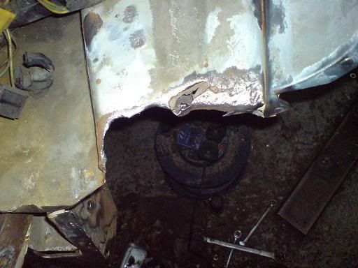

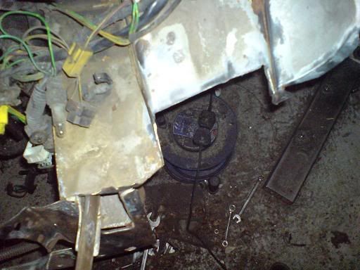

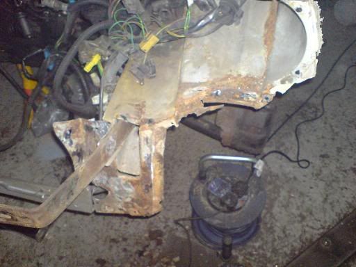

Whilst engine was out gave the engine bay a good seeing to. As always with a 20 year old car there was rust. Mainly from accident damage not repaired correctly and rust set in on a crumpled area behind N/S headlamp area.

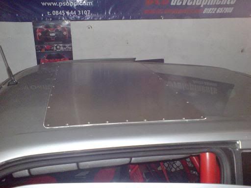

Decided to lose 15Kg
Pace kit going in
Cant wait to get her back.

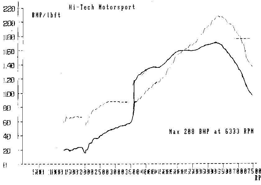

Well all is sorted and today I got her back from final tune after running her on for a thousand mile. She is running like a dream and pulls like a train from 3.5K onwards. Reaching peak torque and power lower in the rev range than previous engine, all the better means I can limit this engine down to 7.2K without affecting its performance.
Anyway this is the final run she did as you can see it's quite apparent when it comes "on cam"
