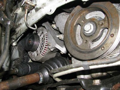

If you insist on using a pressure washer do it from a distance and turn it down as low as it will go, seal the electrics with cling film/plastic bags and elastic bands etc to stop any water getting in

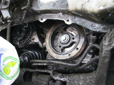

I Used a pressure washer to clean the left hand side of engine (where aux belt is etc) and it worked a treat Sprayed 'gunk' and engine degreaser etc all over as had oil leak that got onto belt and got flicked everywhere. Left it for 30 mins then pressure washed the lot. Just make sure you cover up any electrical points, wires, delicate plastics etc.
