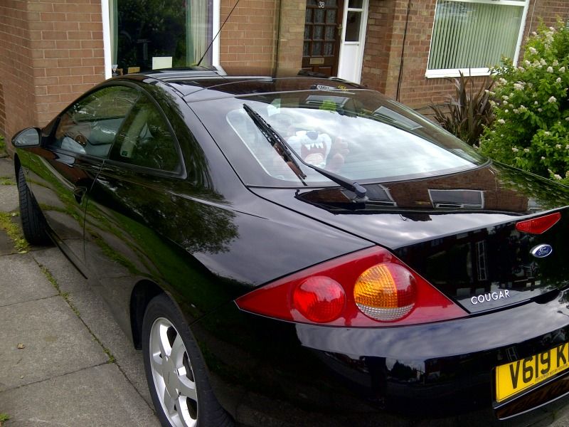

And now my new one.
Spent two days cleanig in and out, two new front tyres fitted and two to come in morning for back !
Any idea what colour black this is, my paint code dont seem to be listed in motor factors just need name so I can find right one.

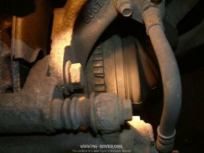

Dunno yet, just in stages of tidying a few little dings and scratches up and making sure everythings mechanically ok, need to look at brakes as feels like maybe a warped disc as it seems to feel like abs coming on and off as braking. Its got an induction kit on that sounds awesome.
Check the ABS reluctor ring(s) before anything else. If it has a crack in it, the ABS will fire at low speed. Annoying, but common and not terminal.

Where do I find them ? Can they be fixed ?

On the wheel hubs. Take the front wheels off and you'll see them - they're ridged rings that spin with the wheel. Here's a pic:
I have no idea how easy they are to replace on Fords, (on Rovers you just nead to heat them) and I don't know if that's your issue - but it's a good place to start. In my experience, most ABS faults are the rings, the sensor, or crud between the two. I always start with the cheapest fix, so...
Yeah seen paint codes but they don't match anything on my vin plate !
I don't want to tell you that you ain't reading it right but... unless it's been resprayed, that's a (beautiful) Ebony you have there, mate. Look for the E.
