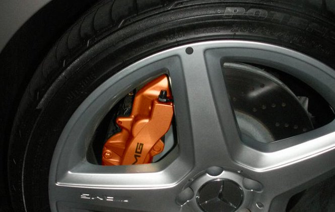

Green Cougar........What colour brake calipers?
I might have to do a photo shop edit to see what looks good before I commit to painting...... I like the sound of Silver though.....but just thinking if it will clash with the alloys......
The only thing I will say about painting calipers is that you must be careful around the area of the bleed nipples. We were unable to bleed Rich Elliot's (though I think he's got new calipers since) because the paint had seeped into the threads and they could not be undone.
