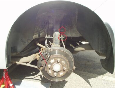

I did notice that the brake lines were mounted to the rear suspension and were rubbing slightly. Added a bit of spiral wrap to protect. Do you know if this is a common issue?

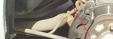

The brake pipes should be secured to the bracket on the rear strut with a rubber grommet and be prevented from rubbing on the strut by the other grommet above it.
(Ignore the line through the caliper).
it was this line I was looking at. It that just the handbrake cable? I did wonder why it would be mounted to the suspension

Yes, that's the handbrake cable. 👍
Just forward of there they should be secured by a rubber grommet clipped into a hook on the rod bracket bolted to the bottom of the car.
Yes, that's the handbrake cable, not the main hydraulic brake line.
Sounds like you've done what you can for the minute, (and lord knows what your tester will think of that) but if it works and applies the correct force, no problem. An advisory at worst.
Replacing that cable is hilariously funny - let's just say that you'll learn more about that kitty's belly than you ever wanted to - but it's not expensive at all.
