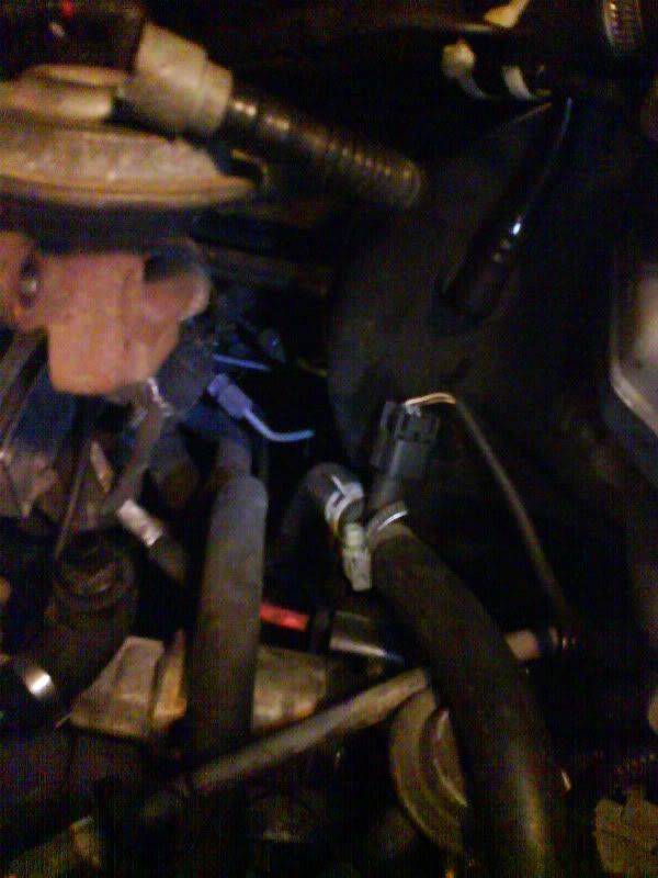

on the v6 its these 2 pipes under the throttle body, the one with the sensor in and the other to the left of it
