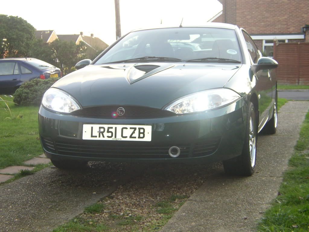

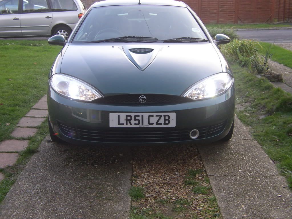

Fitted the H7 6000K's i got from Martin (Racebits) today. "So what" You might think to yourself, "thats no mean feat". Well believe me it is for someone who doesn't know one end of a spanner to another :D. I'm quite chuffed cos i was going to stick it in a local garage to get them done but i thought i'd have a go cos you don't learn unless you try eh ? I'm pleased with the results and the only problem i had was where to put the ballasts. But i got there in the end (y)
Anyway i thought i'd stick some pics up.
Can't wait to go out in the dark :D
Make's the sidelights look flippin stupid tho. I'll have to change them.

Well done! Its a nice mod to get done because the results are so obvious. Did mine a couple of weeks ago and still love 'em. Even thinking of getting some for the main beam as well but that creates double problems with the ballast positioning. Shame no-one does a double ballast. I read on a forum somewhere that there are the equivalent ones for the fogs/driving lights and side lights so have been looking for them.
Cars looking good Nick!

Went out for a spin about an hour ago Ian and the difference is amazing. Everything's bright infront of you instead of being yellowish.
The only thing i noticed is they make the high beam useless. You turn them on and you get a yellow on white effect. Found the best thing to do was use the low beam adjuster. keep it down on lit roads then raise them up on unlit roads. Works a treat. They make the sidelights look cr*p tho. Got to change them. No light out indicater on the dash either.
I Really recomend this mod. Well worth it (y)
