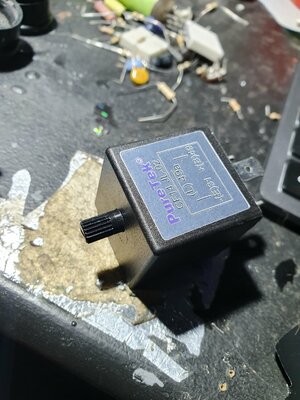

so if u are crazy like me about led bulbs but HATE the damn resistors that u need to stop fast flashing THIS is what u need.
its a plug and play for the cougar(alltho they dont list it for the cougar it DOES work) and works and fits straight out the box.
but what i love about it is the adjustable flash rate adjuster, it'll go from very slow 50 pulses per minute to 200.
so u can fine tune your flashers and do away with them orrible resistors.
MAKE SURE U GET THE RIGHT ONE THO the one the cougar has is model CF14 there is a CF13 which still fits but has the polarity the opposite way round.
has saved soo much bother with putting resistors on every light and was so easy to set up and at just under £7 i give it a 5
