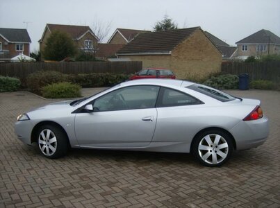

And as i dont have my new car yet i've borrowed a pic of someones stock frosty that mine is the same as.
http://i858.photobucket.com/albums/ab143/jovisd79/Cougar/car442.jpg?t=1273863978

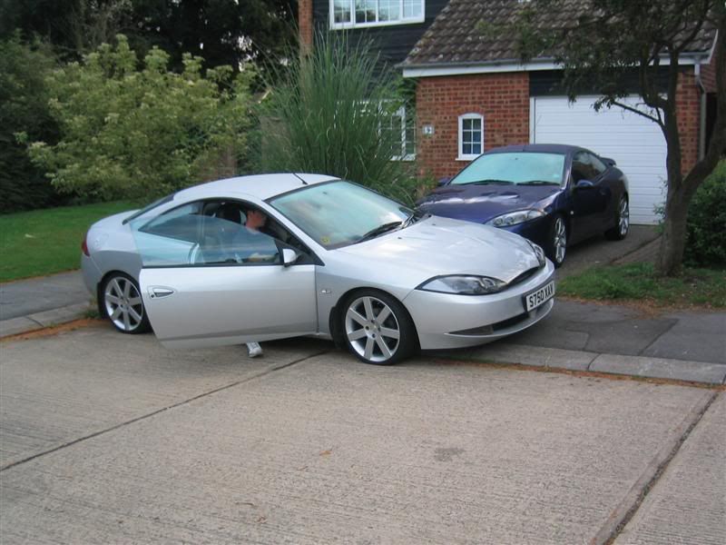

Not too dis-similar to these...
Wicked photoshopping job guys they look awesome!

So still at square one :( - Who's cougar is that wildv6? That looks great as well. Thats the style i like

Sorry to hear they haven't been very helpful. By the sounds of things I woud imagine they should fit with a PCD of 4x108 and an ET40.
Re: Whose Cougar is that which I posted up, well it used to be RichK's now belonging to RichB's missus Ria. It's RichK that I got my tinted headlight covers off.
