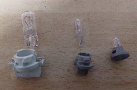

My memory says They are mounted in a holder which turns 1/4 turns out.
The lamps ( bulbs ) themselves are this type of plug in. Although this is an LED type.
Capless push-fit are the main big-dial illumination ones I believe, and dome LEDS will not fit as far as I remember...
The alert bulbs (fogslights, indicator, oil pressure...) are the tiny twist locks and they suck, but there are no valid replacements that I've seen. I might be wrong about that.
Left is dash panel and headlamp switch panel illumination - 3 watt wedge based bulb.*
Middle is, as Chris said above, 1.2 watt wedge based bulb for the warning lamps.
Right is for the HVAC display.
There is some discussion about alternatives for the HVAC bulbs here:
*Don't be tempted to fit 5w instead of the 3w as you could end-up with odd electrical gremlins going on with your dash and possibly a melted bulb socket in your headlamp switch.
