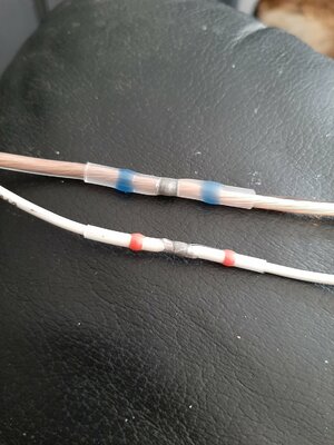

they are basically high temp heat shrink with 2 rings of glue and low temp solder in them ..
the solder melts at they say around 135c altho they worked better at 180c
what i love about them is they are waterproof , the rings are the glue and seal the cable ,i cant pull em apart.
i used a small gas powered heat gun which did the job great..
quite impressed with em to be honest...
cant mark em down. ,brilliant.
their available on amazon and ebay in various quantity boxes.
altho i got the gas torch from amazon.20210908_082136.jpg20210909_154631.jpg

yes i thought this too about tinning the wires first however there was a problem.
the solder i had tined with would simply not melt and so the connector solder couldn't saturate it when it melted...suppose the wires ur tinning would need low temp solder too..
altho i did a stress test on the joints and tbh it withstood far more tugging than the good ol crush type, i also like that water cant get in.
