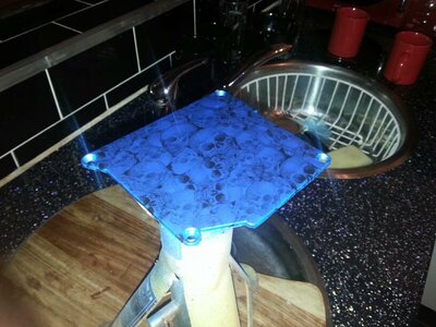

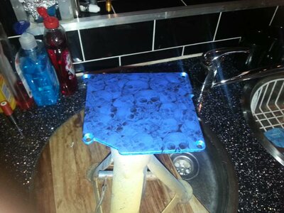

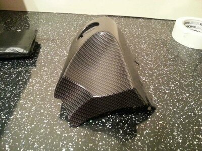

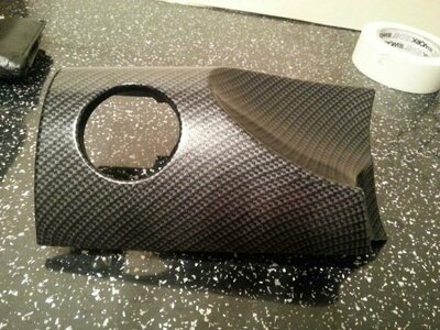

uploadfromtaptalk1377637093323.jpgTried my headlight switch sourround tonight and turned out quite tatty, loads of tiny air bubbles between the film and the part and a few creases, I think the water was a little too warm and I either didnt put enough activator on or I was too quick to dip!..... live and learn :) uploadfromtaptalk1377636965810.jpguploadfromtaptalk1377636990110.jpg
Even that looks passable though Dave, and the creases are underneath and out of sight. :thumbsup:
Nah......if you look closer on the 2nd pic you can see all the tiny bubbles......it will be flatted and done again until im happy with it :o

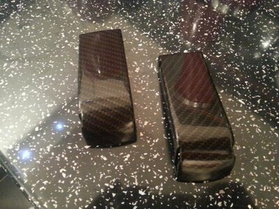

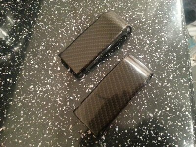

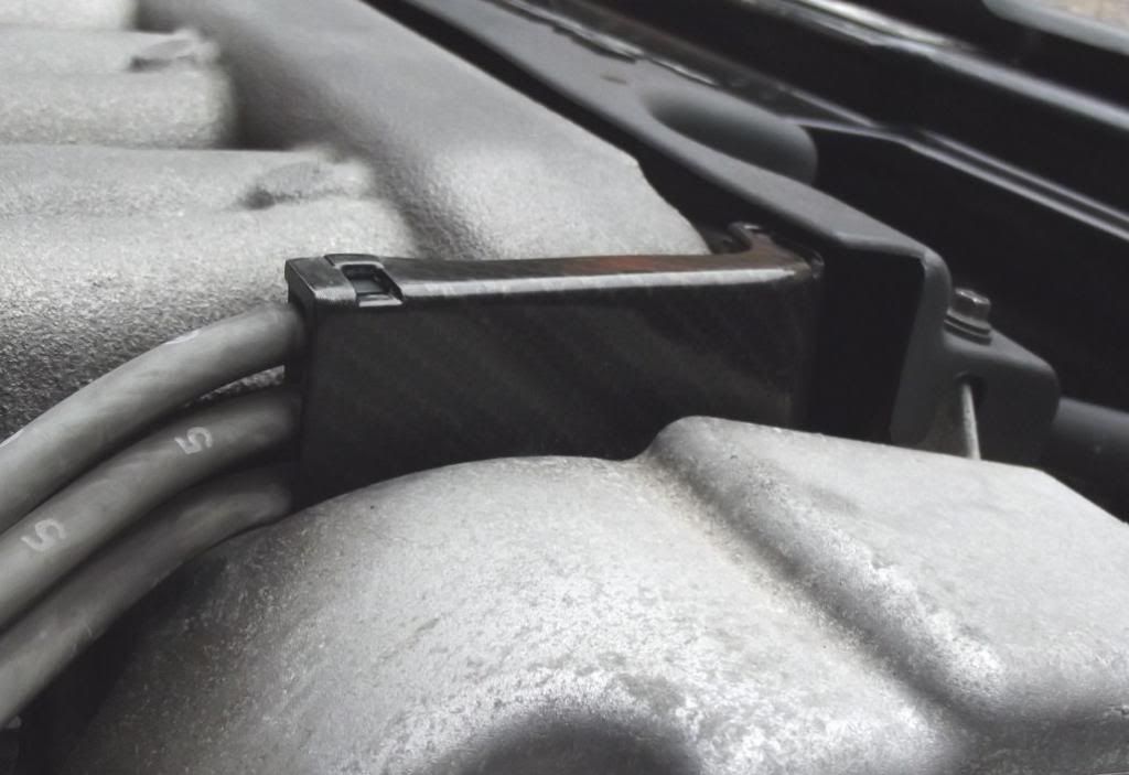

Heres some ht lead cover corner thingys I did for mako in gold carbon effect with a black base, they turned out pretty authentic looking imho :thumbup:
