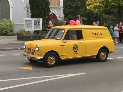

We've just returned to the UK after 7 weeks touring New Zealand and whilst there spoke to some vehicle recovery guys after a puncture on our camper. I asked them about Cougars in NZ, they said they had seen them and that generally speaking, anything available in Australia would also find its way to NZ. But I must say in over 4,000 miles I didn't spot a single Cougar ! As you'll see on the forum, we have a separate thread for 'Cougar Spotting'. Here is something I did spot though !
