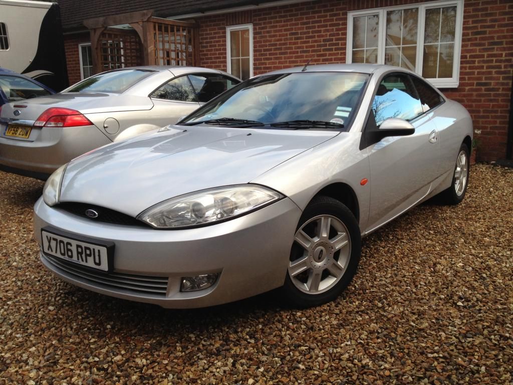

Here are a few more pics of the Cougar that I snapped when I got it back to Surrey on Wednesday afternoon.

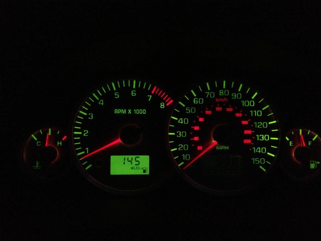

One thing I have noticed, and here is my first question, is that the backlight for the clock/odometer doesn't work. Is this likely to just be a bulb? If so, what is involved in removing the instrument cluster to replace the bulbs?
The main dash illuminating bulbs are push-fit wedge based 3w 501's of which there are 3.
The two LED panels are lit by R286 wedge based bulbs, one for each panel, accessed from the rear.
