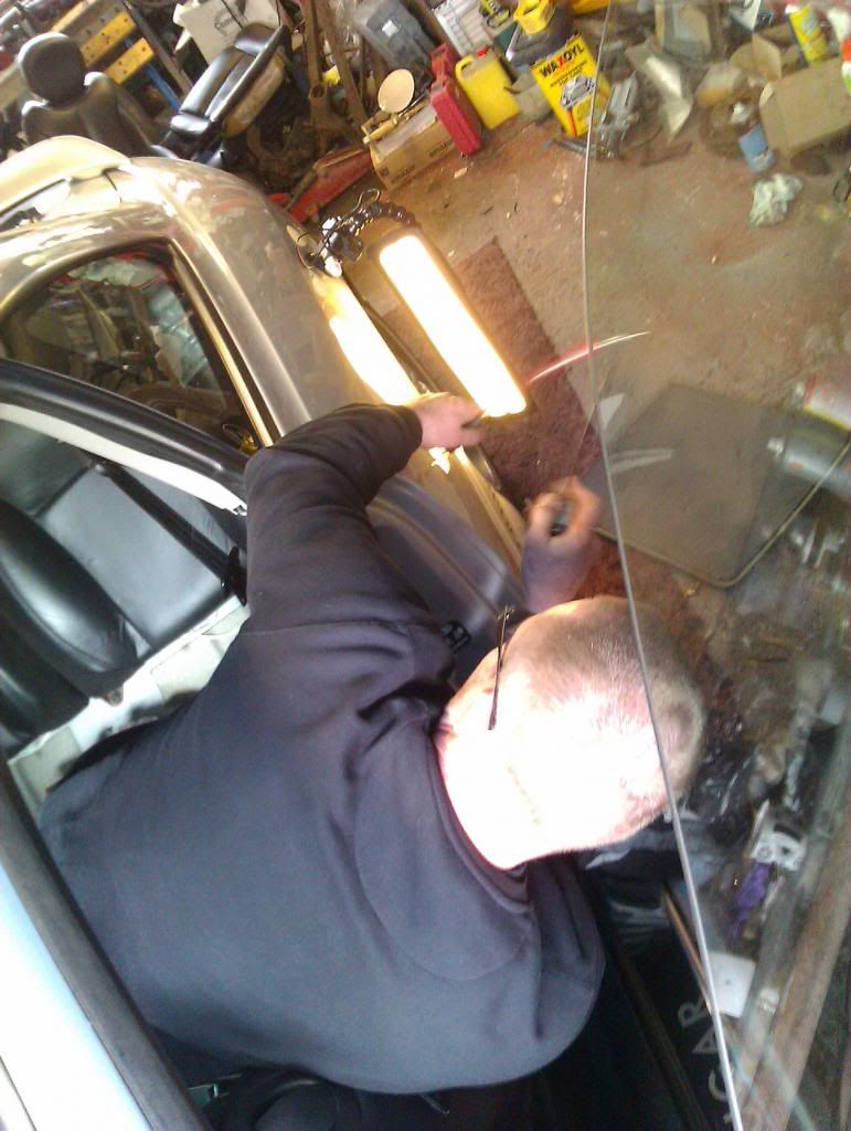

I rang and arranged for Tony to pay me a visit. He rolled up today at about 1.00pm, reversed his van down the drive, looked at the dents and immediately said, oh yes, we'll soon have this done. About one hour later and the side of the car is straight again. I stood and watched this guy at work, and it was like watching an artist at work. I stood where i could see the affect of the light reflection on the panel and the only way i can describe what happened is, imagine a dent actually happening in slow motion but in reverse. Worth every penny imo.

Tony at work, tapping the high points in. Btw, i had removed the seat base and interior rear card from that side for access and to save Tony some time, and myself a few quid

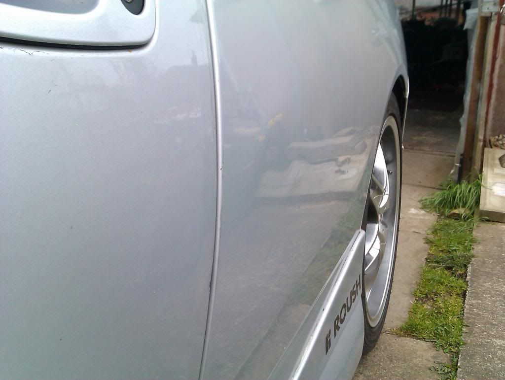

By the time i went to take the "after" shot, it was raining but.............
